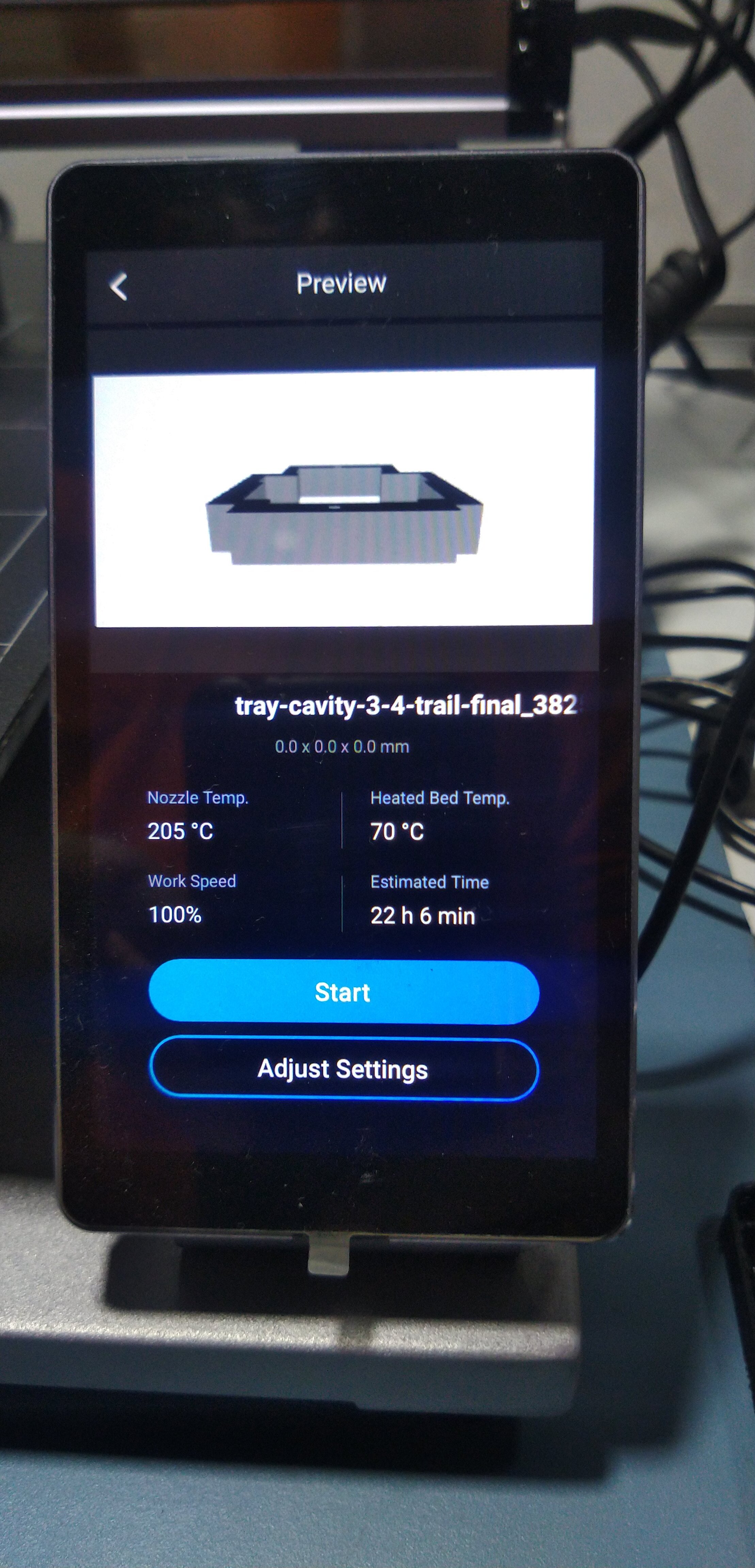

I have been trying 3 d printing since a month now and i am a fresher in this interesting field. I today experienced random freeze today , the job timing was 22 hours and unfortunately may be due to power loss the printing may have halted. Now when i see the screen i was surprise to see the recovery screen is not displayed. Hence now i have no option but to restart the same program.
Also is there any relation with the work speed since the work speed was 150% and are there any guidelines for work speed.
As per my views when the program is for long time the printing should auto recover in case of power loss condition. Now only option i see is to install a UPS.
Can i expect some solution on this, i have the latest version on the system.
Power recovery and runout recovery ONLY work if you start the job from the touch screen.
If you used the touch screen to start the job, then you have found a bug.
Please send me the log files and the G-code file to me for further investigation. Tell me the approximate time when the issue happened.

Thanks for quick reply. also noted the reply from IT maze, that auto recovery works only when we start the printing from touch screen, true may be since i started the job from PC after wifi transfer. anyway i am installing a UPS today since i have a job which shall work for 48 hours.
were can i get the log file? the G code for the job as attached.

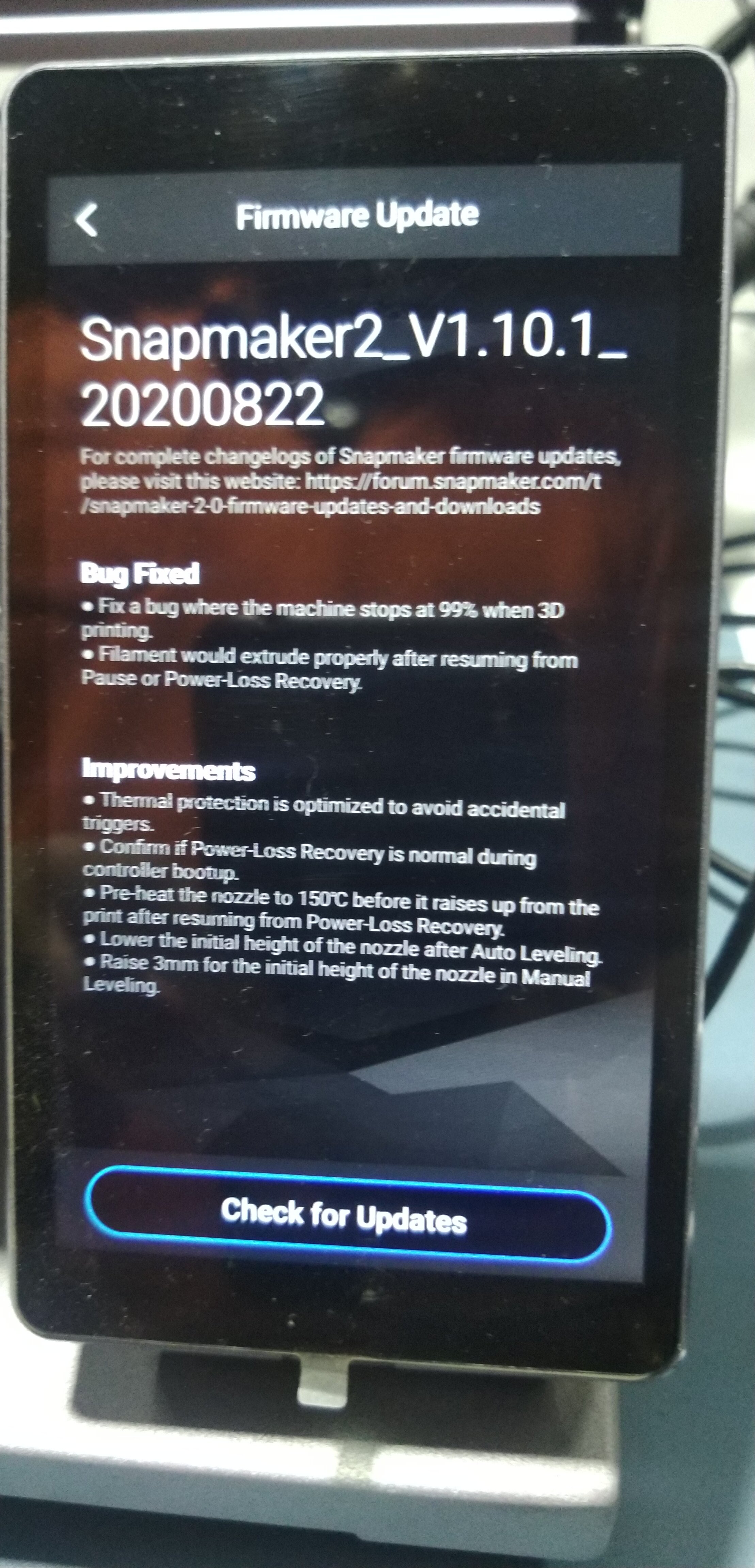

Firmware version V1.10.1_20200822
Touchscreen 1.10.0
Controller V3.2.2
