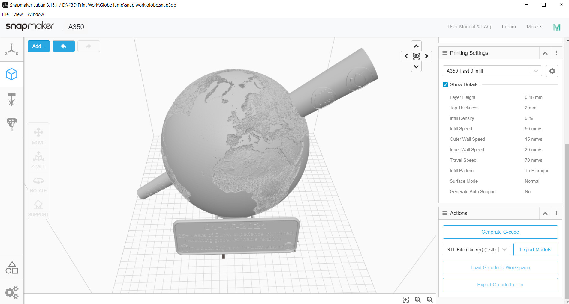

I am trying to print a 195 mm hollow globe that is illuminated by LED. The STL is perfect but when sliced, the model shifts horizontally on about 3/4 of the model. Good it happens on screen and not on the A350 but i would really like to print this product. Any suggestions ?

I havenāt been sitting still myself and wanted to share something that could save time and point at the correct direction. I have been drawing in Solid Edge for 20+ years and that software is typically used for mechanical constructions and very limited as far as modifying imported STL files is concerned. The Globe in the file is a downloaded file that i had to modify a bit to merge wiith my SE files so i downloaded meshmixer to modify and merge the files.
I have done some tests with only the globe and pretty much performing the modifications (cut and remove material) and compared slicing the original file and the modified file.
My conclusion is that the shifting is a result of the Meshmaker modifications. The wierd thing is that when the modified globe is imported into Luban is looks perfect, but when sliiced, it doesnāt.
