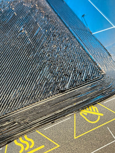

Pla black
215 C nozzle Temp
70 C bed temp
All of my prints are now very rough. I have dry filament and the nozzle Is not very old.
Any suggestions?

We see your first layer, correct?
It seems your bed level is not on point or its overextruding.
Try to correct it by live z-offset on the touchscreen while printing.
