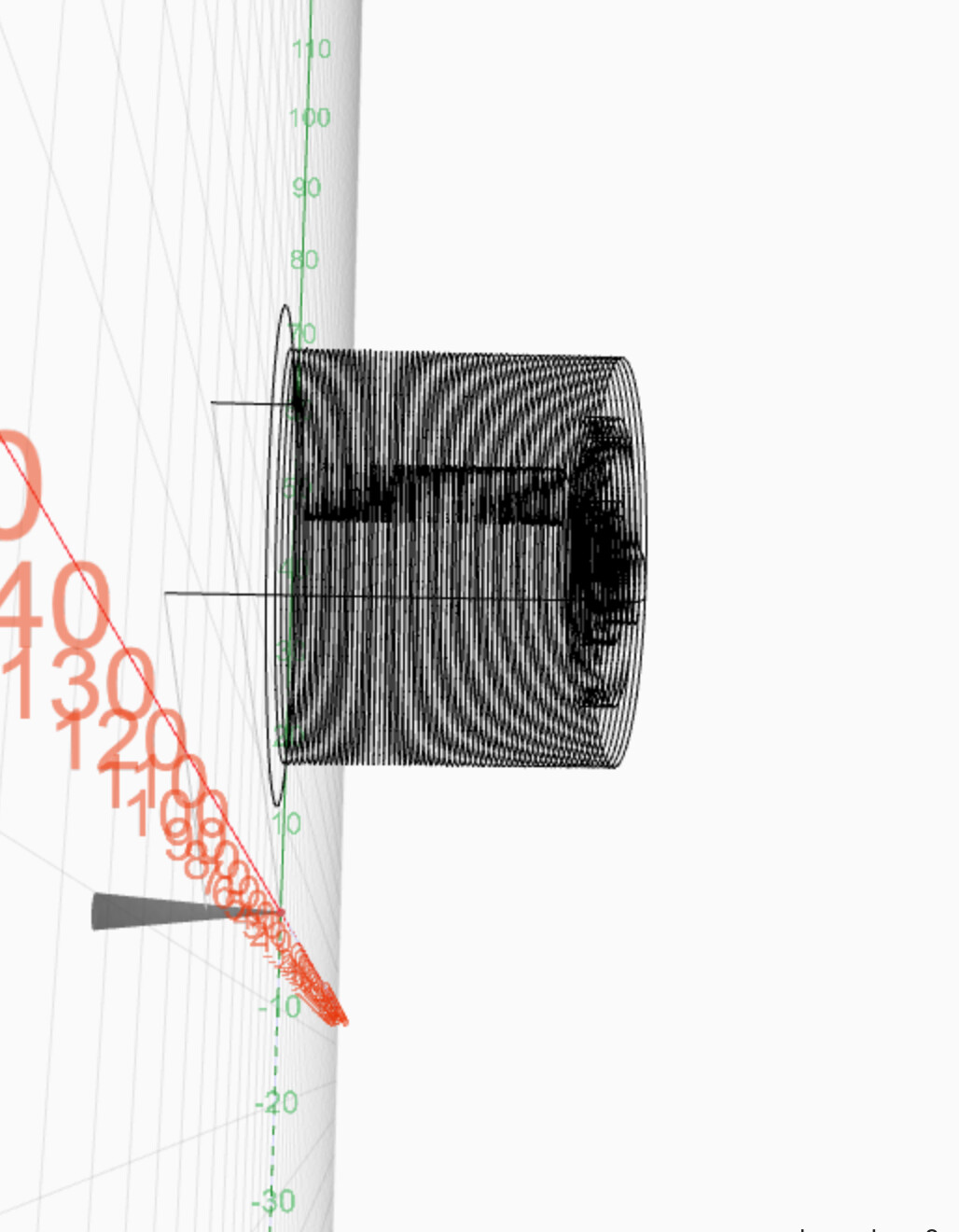

Here’s my question… Is there a way fo rotate around the Z-axis in the WORKSPACE view of luban (the view when you review the g-code just prior to printing)? The mouse only seems to rotate around the x and y axes. I also want to visually see how things look around the Z axis, but I cant seem to find any keyboard/mouse combination that lets me rotate that way.

You can rotate the model around the X axes and Y axes now. The position of the mouse in space is mapped to the XOY plane to form a datum point through which it can be rotated around the x and y axes.
Because it is hard to make the reference point to the ZOY plane, you are not allowed to rotate the model around the Z axis.
If you tilt it on it’s side, then if you click and drag up & down it will let you rotate around the z.

@sdj544, for a second I thought you were joking.
But this actually works.
It’s a good work around to at lease visually inspect the visual depiction of the gcode.
Thank you!
Nope, but you will need to lie down while doing it. :wink:
