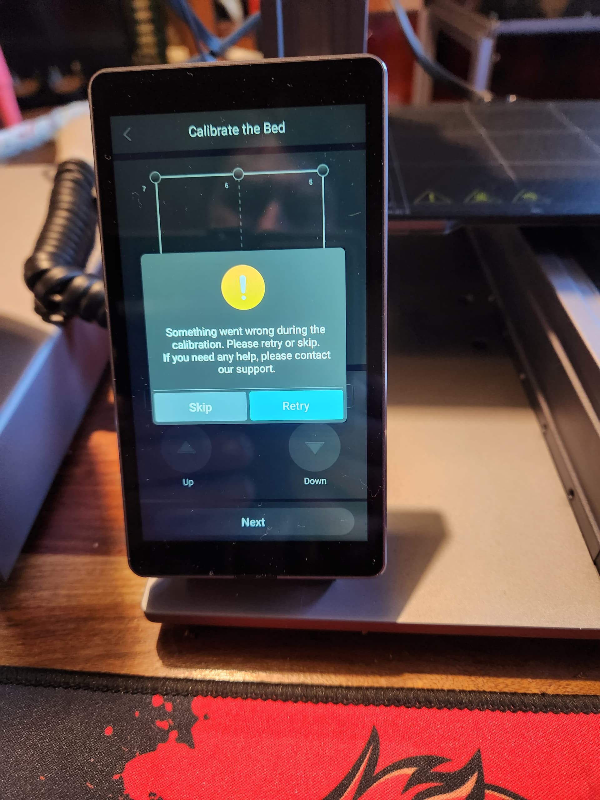

When i get to bed leveling the bed just goes to the front makes a lot of noise for a bit then it wants me to set middle when it is in the corner. I am missing something i know but i can’t see it
Can you show pictures of the assembly? There might be something not assembled correctly.

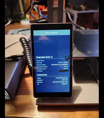

So i have updated my firmware and naw i can’t get it to move at all

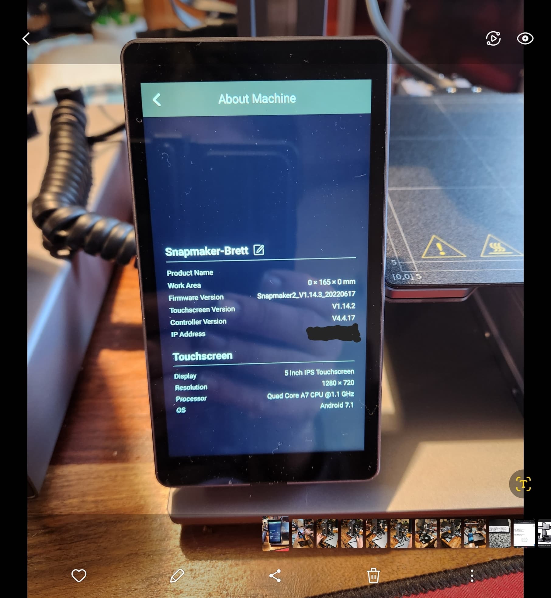

Try unplugging everything, leaving power off for at least 30 seconds, and plugging it all back in. The touchscreen is showing your work area as being 0x165x0 (that’s definitely not right) and is not showing the product name (Snapmaker A150) or an image of a Snapmaker machine like it should be. Seems like it may not be sensing/recognizing your machine properly.
Just tried unplug and shutdown for 2 mins and still the same :frowning:

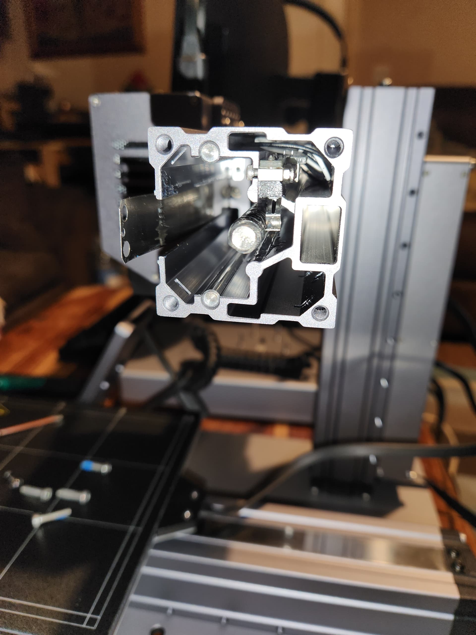

So i have found a fault i got a hunch it was the x axis so i put on my big boy pants and opened it up and the micro switch was broken what i dont know is if that is enough to stop it all working
@Caveman Yes, it will stop it from working. That microswitch is the endstop that the machine uses to know exactly where the carriage is located. Without it, the machine doesn’t know where it’s at, and so cannot perform any functions. If your machine is still under warranty, contact support and let them know; should get a free replacement. If it is not under warranty, you can still contact them to purchase a replacement rail or even just the microswitch. Another option would be that you can find the microswitches online for a lot cheaper, BUT depending on how it is broken (got a picture by chance?), it may require de-soldering the circuit board to remove to old switch and soldering the new one back into place, or you may only need to swap out the metal clip on the switch (a part that is very easily and commonly damaged by owners who venture into rail disassembly, as was the case for me).

Yes m8
The tab is all floppy and there is no click when u give it a push and at rest it sits lower than it should
