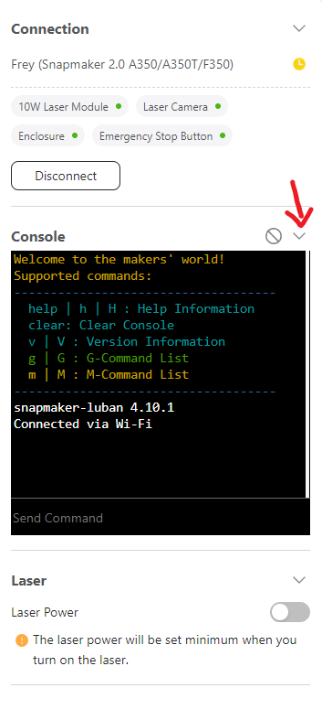

I would try that, but how can I type that in ? Luban gives me no access to my console and in the console I do not find where I can type that order in. Guess the new firmware makes that rather complicated. Or , if you found the trick , I owe you something !
In Luban, the console is right under the connection area. It may have been collapsed and you’ll need to expand it with the little arrow next to it.
wow thanks
in what line do you type the command M1010 S11 ?
There’s an input line just below the terminal window. Thanks to skre for finding that little tidbit.
ok, I tried, but that does not change anything
it still continues to send the error message enclosure door open
You have to type it in all caps.
Sadly the custom commands for the Artisan seem different from the 2.0, and Snapmaker has not released them. I don’t have an artisan, nor access to one for testing so I can’t help further.
