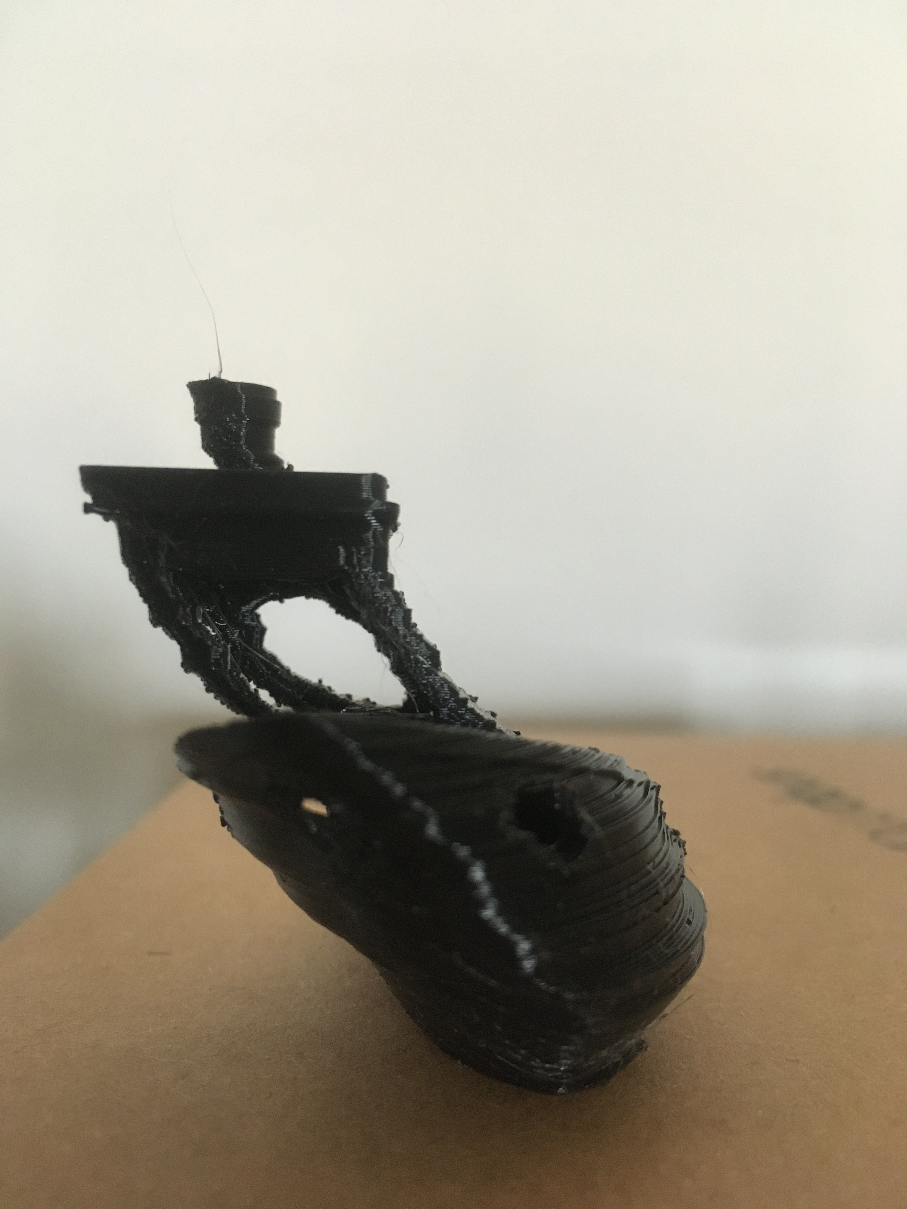

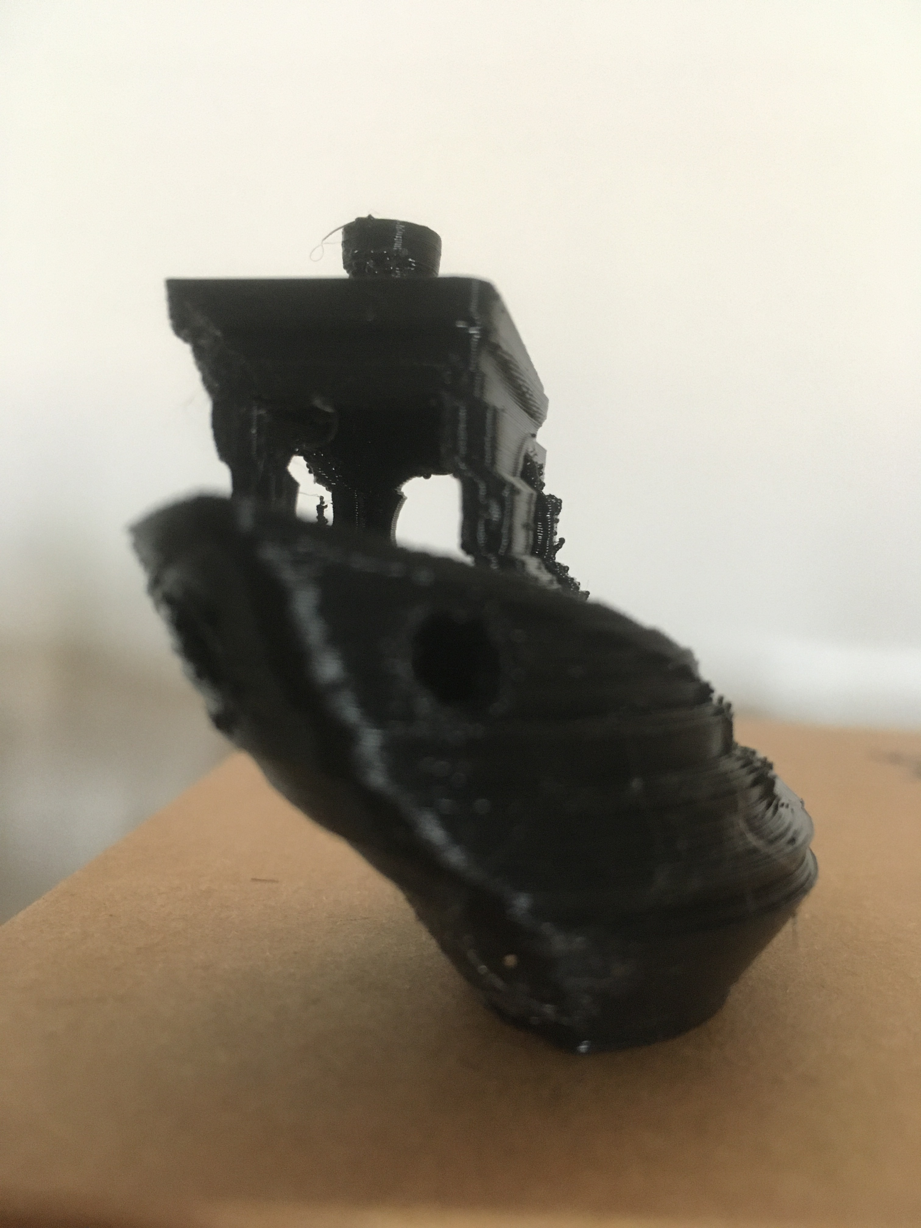

Hi guys i have just bought a Snapmaker a350 on december month, after a blackout it began to print object inclined on a side. So i reset as factory default but the result is the same, like in the photos. Can you help me?

Hi cesare76m, could you please provide the G-code via message? We’ll try to find out the problem.
i used another slicer, prusa, and with this software there’s no problem how you can see in the photos. i tried to reinstall liuban but there’s no changes

Our R&D colleague said that the acceleration is set too high and that you need to disable Enabled Acceleration Control in the Speed Control (Advanced/All Mode).
You could try if this works. :smile:
thanks to R&D, you solved my trouble about printing, because unity is strenght :wink:
