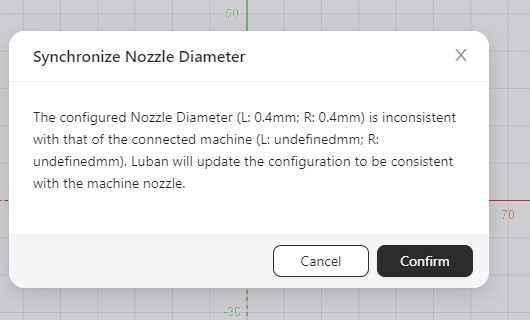

Second Issue :
This began with the Luban V4.7.3 upgrade. I get a warning concerning Nozzle Diameter Synchronization when I attempt to start printing. I have not been able to find the cause of this warning to prevent it.
Luban Warning

Just ignore the sync error, its a known bug, try searching in the forum.
