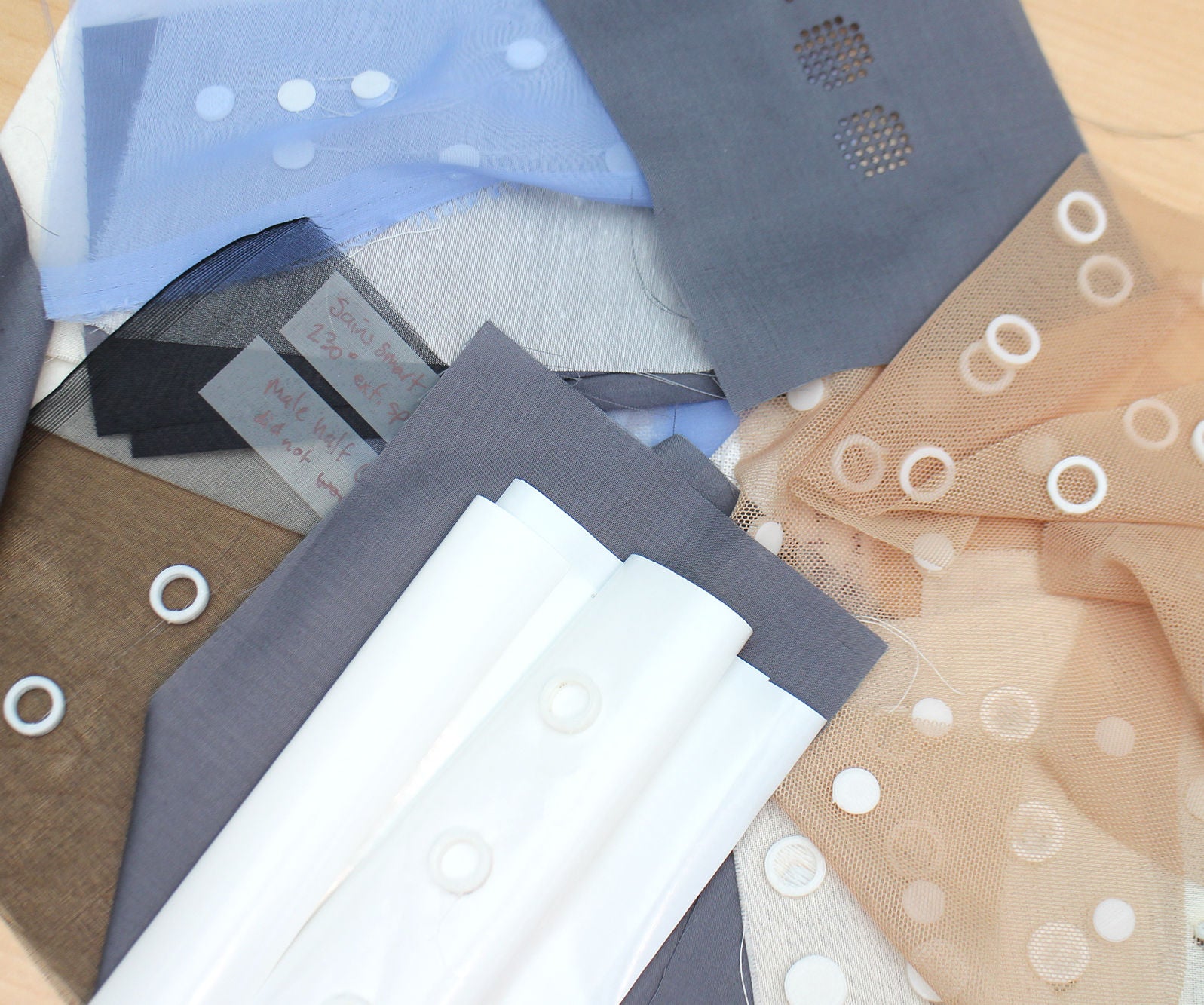

I found an article that goes a little bit in how to do a mesh In between layers of a print.
I was able to imbed the mesh into the print, but it was a pain in the rear, as there was no way to hold it down while it was printing. I’m thinking of trying to setup some sort of g-code that will print or press the head into the mesh and print to tack it in place so that it holds when the overlaying print is going.
