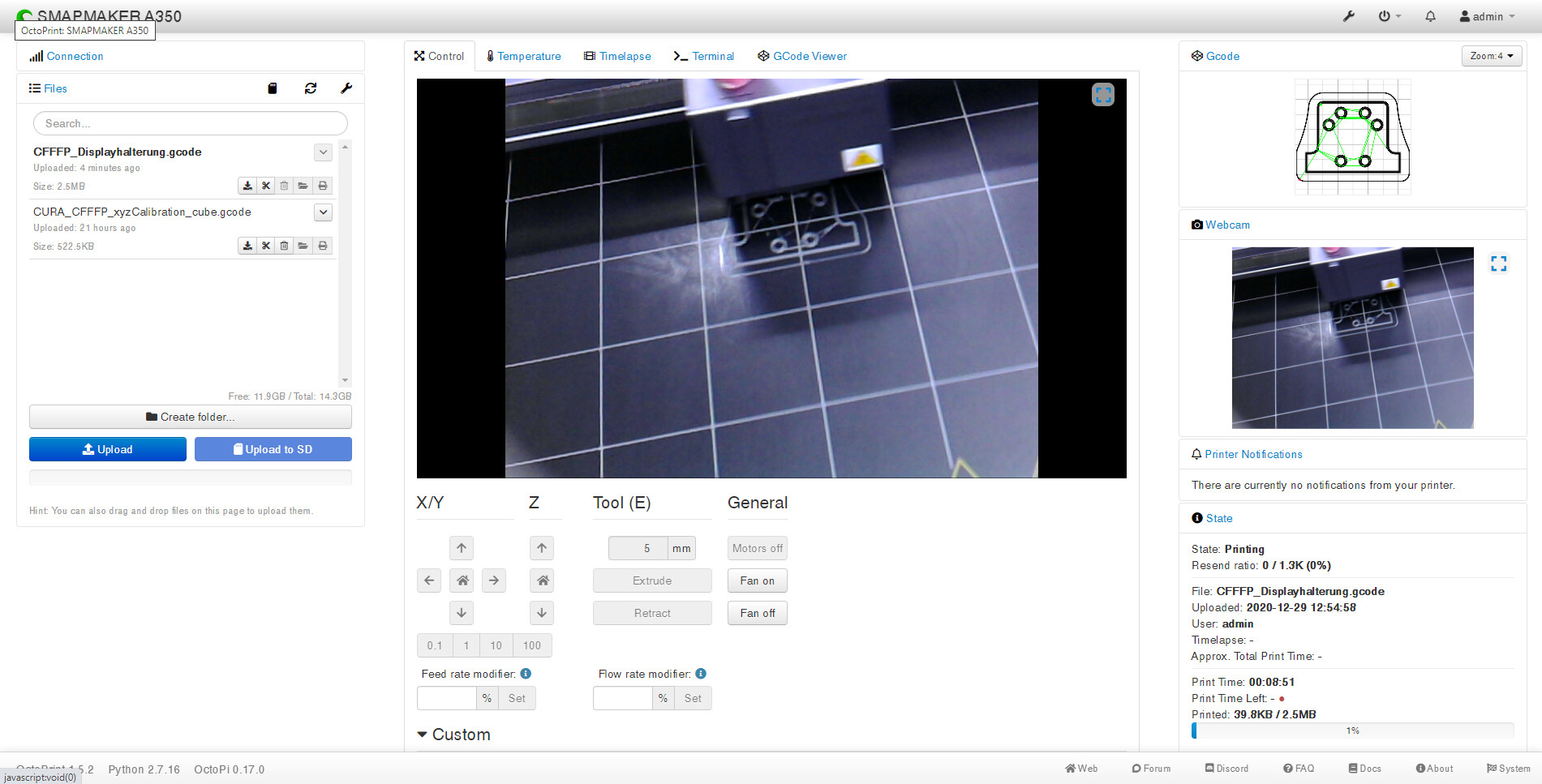

Photo report:
Hi, i am new here. It is my first 3d printer (snapmaker A350).
I am running Octoprint. Can some please post the “Axes” settings.
I also have problems with cura. In my eyes it looks better than Luban.
Please can someone post the Materials. I use the original snapmaker PLA materials.
Thanks from Germany
Stefan
Good materials i get from Material4Print its not a seller its a producer of filament.
The Settings in AXIS are for me:
Settings are only for manual jogging around.
Hope this helps
