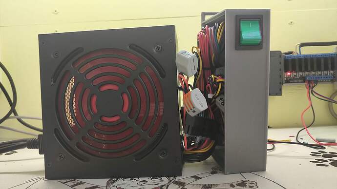

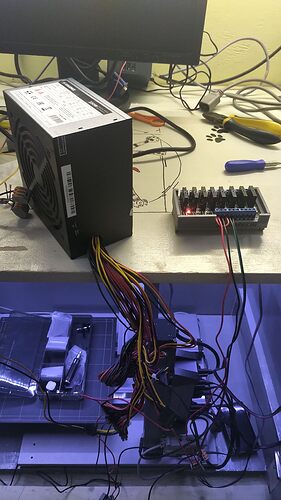

Electrical connection.
ATX power supply - we need
5v on Raspberry Pi
5v on relay module 8 ports
12v on LED stripe
12v on Router Mikrotik
Mount DIN Rails

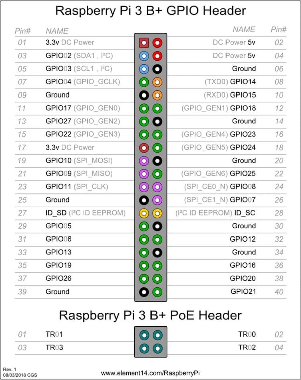

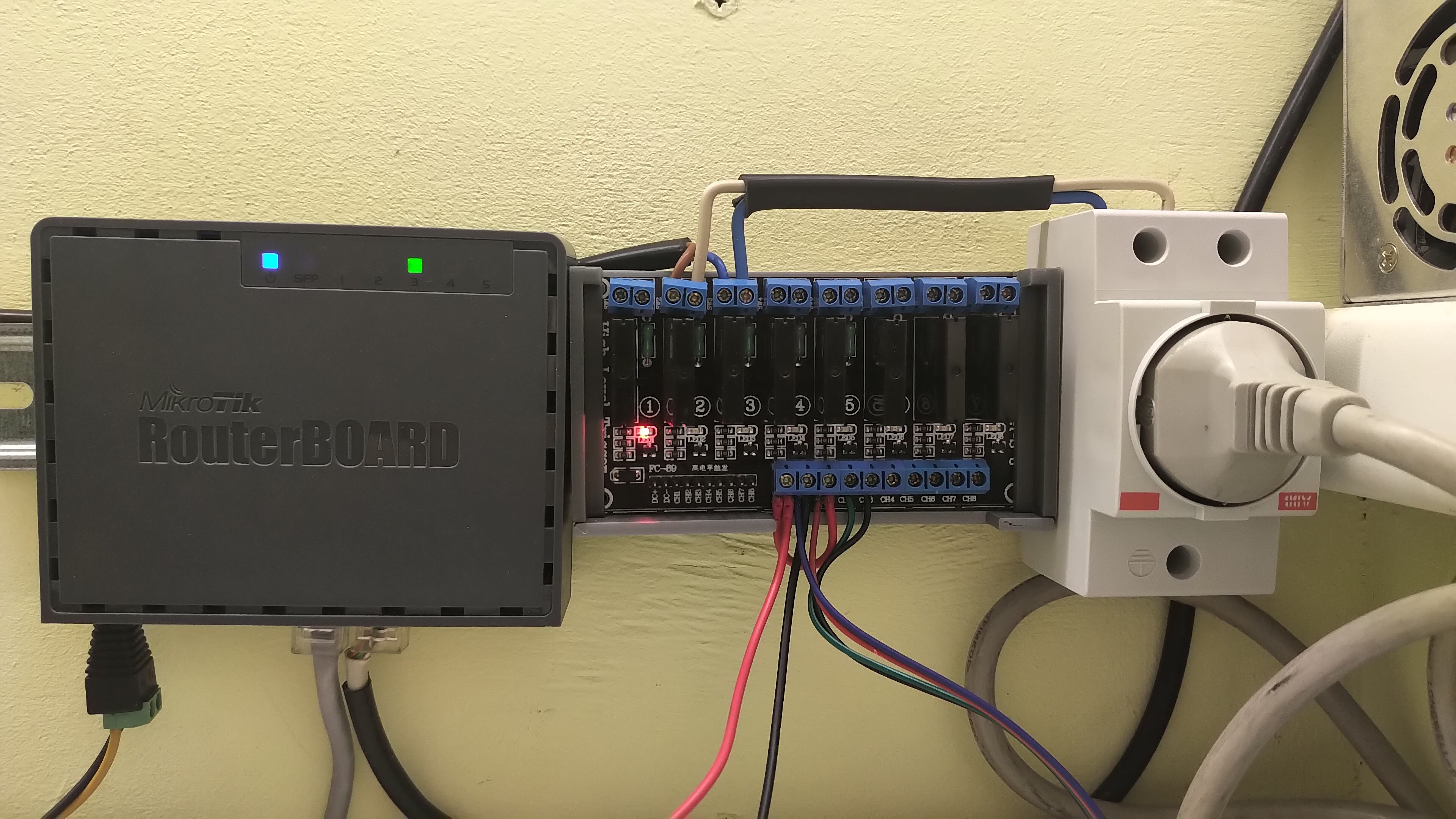

So. We supply power to the Mikrotik router - 12v everything is clear here.
Next, we supply 5V power to the DC + DC-Relay module and DC + we link with switch 1 (+ 5V), from it we take power to the Raspberry.
Ports 1 and DC-on the Relay connect to Raspberry gpio pins 2 and 6.
In this configuration, you can see that the LED on port 1 is on, which means that the voltage is supplied to the Raspberry.
Ports 2 and 3 on the Relay are connected to the Raspberry gpio pin 11 and 13 (GPIO17 and GPIO27) to control the outlet to which we connect our printer.
