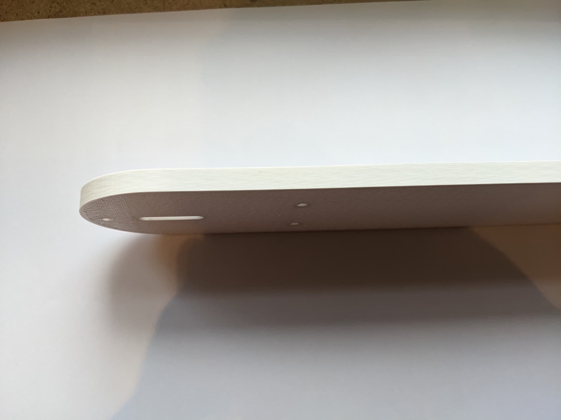

Anyway, the pics:
Below two examples, both in eSun PLA+. First example does not have a nice top surface, yet this is printed with just two top layers (as I’m optimizing for speed).
Second example has a better top surface: this is still printed with only two top surfaces but with the topmost skin layer printed at 0,4mm line width and 60 mm/s (so also close to 9 mm³/s). It yields a lot better result than the first example. Of course this could be further ameliorated by printing slower and/or with more top layers.

Second example: side frame for a small conveyor belt, about 30 cm x 5 cm:
Top side, better, not perfect, but also just two layers of which topmost layer at line width 0,4mm@60mm/s:
Bottom side (imo acceptable, but bed calibration or z offset was a little bit off this time):
Layers:
