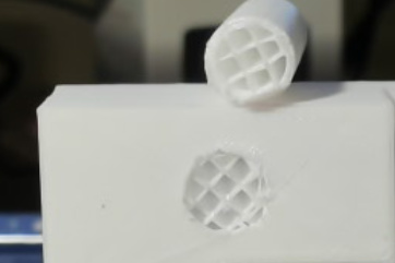

Hopefully this will save a few newbies from some pain. I have a new lesson to learn, infills and outer wall thickness. The parts prototype I designed a few days back came to some grief. It printed beautifully with Simplify3D with the normal default settings.
Well, one of the cylindrical pegs snapped off where it joins the main body…my fault. However I had not applied much force to it when this happened. On closer inspection you can see the infill pattern and the wall thickness. For scale the peg is 8mm in diameter. The peg wall would be less that 1mm (by sight)
I am now looking into improving the strength of the peg, with infill and or wall thickness. learning, learning, learning.

Hi @doug. That’s a shame it broke. I agree that more material would make it stronger. Additionally, the transition from the flat surface to the peg is quite sharp. That’s an area of stress concentration and a fillet might help. Would that compromise the function?

Rick, that is a method I have used on a number of items to improve structural strength. I was not expecting the problem on such a short item. I must admit I was not expecting so much infill in the 8mm dia. cylinder.

@doug sorry I’m coming into this late, but did you increase the thickness of the wall? I see you only had 2 walls (0.8mm) on those pegs. You should probably go with 4 walls (1.6mm) and then keep the same infill. And since you’re using Simplify3d, you can set different settings for bottom half and too half using processes. Angus of Maker Muse did a video explaining the process.
