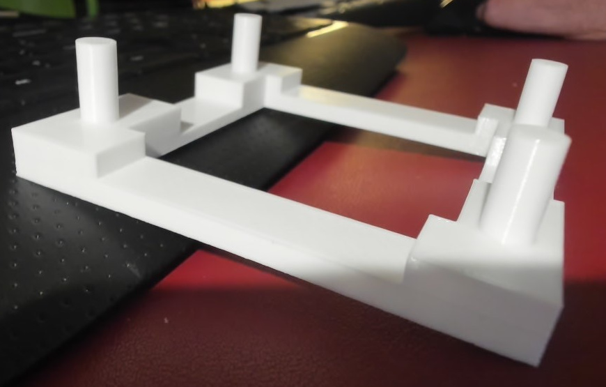

The first little object printed well with Simplify3D. I have just fired off this print which is a prototype part for my project. the rectangular shape is 96x96mm.
I am just using the default settings, other than the start and end gcodes, plus the temperatures and I had to change the origin as the first layer was off the build plate. Fixed and going again. Further prints I will need to slow it down, it is going like a Ferrari at the moment, which I don’t mind, so that I can see how this part would fit in my project. I am most interested to see the print quality given that is is going so fast.
I am using Proto-Plasta HTPLA at temps of 220c /70c

wow, I cannot bevel the difference in printing just by using Simplify3d. This is part finished as clean as whistle, even when it printed so fast.
