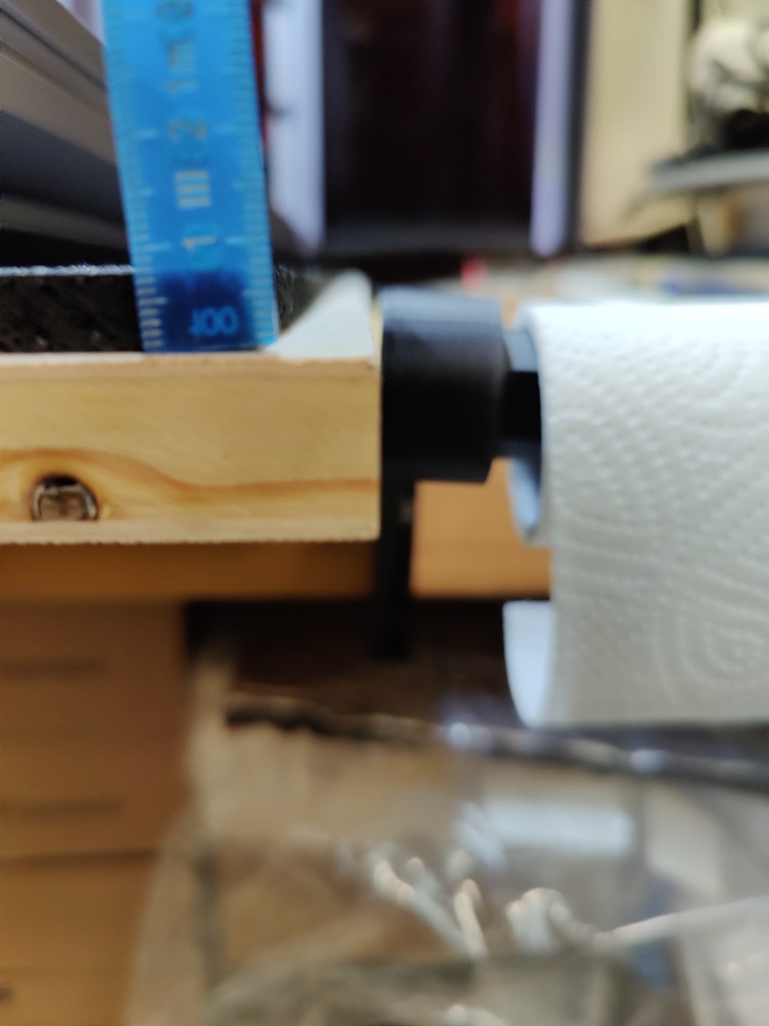

You do not need to invent anything, solution already exists, and that is.
This one:
Is anti-slip mat that can be bought ready, is stable does not give way and also isolates the noise.
I have you from our work and have you completely under the Snapmaker as well as under the housing mounted.
It is 25cm wide and 8mm thick length for us 2m.
Does what it should and perfectly
