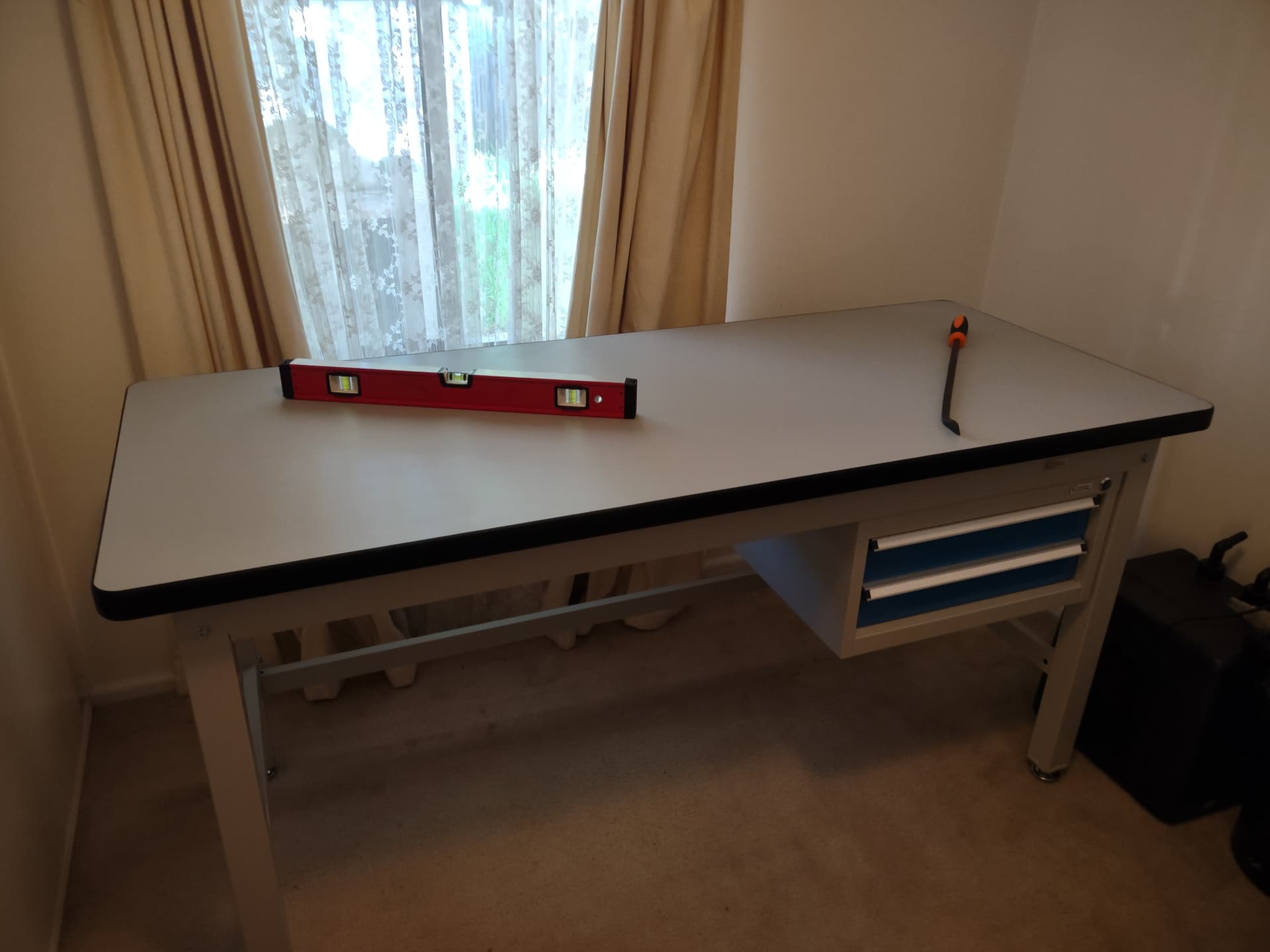

I’m a crusty old machinist and just taken the plunge with the Snapmaker A350 YaY!
First job was to get a nice machine table.
And my first question before I assemble and kick off with the journey.
I think my table is overkill but I’m very happy.
How important is the machine table? Being predominantly manual machinist there is a feel that does not transfer with CNC/gcode dynamics :thinking:
Genuine question tho, I am commissioning my machine in my spare room on carpet which seems odd
Pug
You’ve already got a better setup than many of us, I think (my A150 is sitting on an old cabinet door on a wooden crate in the one corner I had available to tuck it into, and it probably isn’t very level). For the most part, what seems to be most important is getting the frame of the Snapmaker itself properly and firmly assembled, with the linear modules square and the bed as flat as reasonably possible. Table itself shouldn’t matter much as long as it’s solid enough not to vibrate apart.

I made the mistake of putting something just a bit taller than the bed near the right side of my v1. During startup, the X axis was lowered on to it, which lifted the base of the machine off the desk about 1cm on that side. I didn’t notice it, and it didn’t affect the results.
So it seems that as long as all the axises are perpendicular to each other, it doesn’t really matter how they are oriented. Although if you do it wrong enough, you might have issues with cable tension or filament feed tension. Some users have had issues with cables rubbing during movement, and getting caught on the Y axises. A lot of users have issues with filament getting snagged and not feeding properly.
