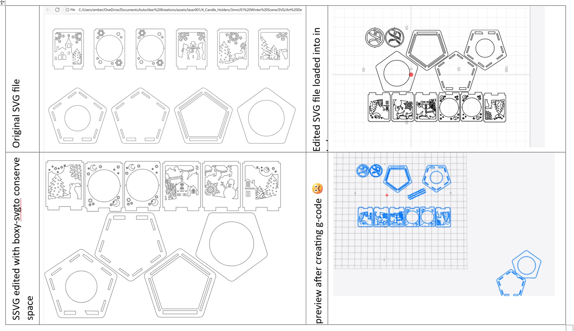

I am trying to cut a file i purchased from etsy. the different parts were very spread out so to conserve material i opened the file in https://boxy-svg.com/ and moved the parts closer together. I downloaded the edited file and loaded it into Luban it looked fine. I made the tool paths but when I generated the g-code two parts were moved way of the workspace. I tried printing the file and the parts that were in the workspace were cut as they were supposed to. I have included photo that show views of the files and screen shots from Luban.

snapmaker 2.0 A250 and 1600mW laser yes they do match
I’ve seen Luban do this multiple times with SVG files.
The way I have gotten it fixed….
Use Inkscape to edit the SVG.
Select all objects (CTRL-A or CMD-A)
Now select the Node tool (N)
From the menu bar, use Object→Union (CTRL-+ or CMD-+)
Save the SVG as a new file.
Now try and load it into Luban.
