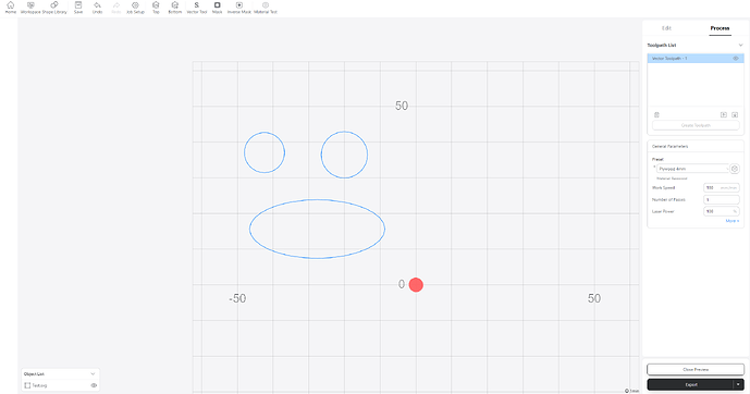

I think i found the reason for the problem (not that this helps to actually cut). Since Luban makes the whole svg into a single object, i can’t use it this way. Different parts are supposed to be cut, while other are supposed to be engraved. So my solution was it to hide all objects that should use different settings and save the files under different names to import it. This seems to work, but it created to problem, that all lines where cut way to often.
I wanted so share one of the files with you to test it and i notices, that it looks like only the one objects was imported correctly and it set how it was supposed to be handled. The two hidden objects are correctly ignored.
But the Preview shows me, that it suddenly had also the hidden objects.
(Next image, see the next post, since i only can add one image per post as a new user)
I didn’t noticed that before, because i added all three objects. This means every object was actually added 3 times. Two should cut 12 times and the last one a single time. So it ended up with 25 cuts for each object.
So i guess a solution would be to create x copies of the object i want and to fully delete the parts that are not visible currently. This should work. This is off course not a very fast workflow :confused:
