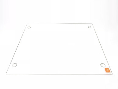

It’s worth repeating the obvious here: glass is a thermal insulator. This will drastically affect bed heat up times and maximum temp. Other printers, like the Ender, it’s typical to put insulation under the heated bed to help.
I have other plans with a silicone 750W AC heater, spare cables are on order and when they show up I’ll assemble it all.
Recommendations for glass?
I bought this glass:
It was a compromise between:
+ Pretty close size fit, a bit longer even.
- Losing some width on the build surface
- Having screw holes, but the magnetic sheet and removable build plate offer decent cover over the holes
+ Not having to buy an oversized plate and cut it down myself
- 3mm thick, wish I could’ve gotten 4
+ Good price
If this doesn’t work out for me in the long haul I’m going to get a 4mm borosilicate plate and a diamond cutoff wheel and just cut my own custom plate.
