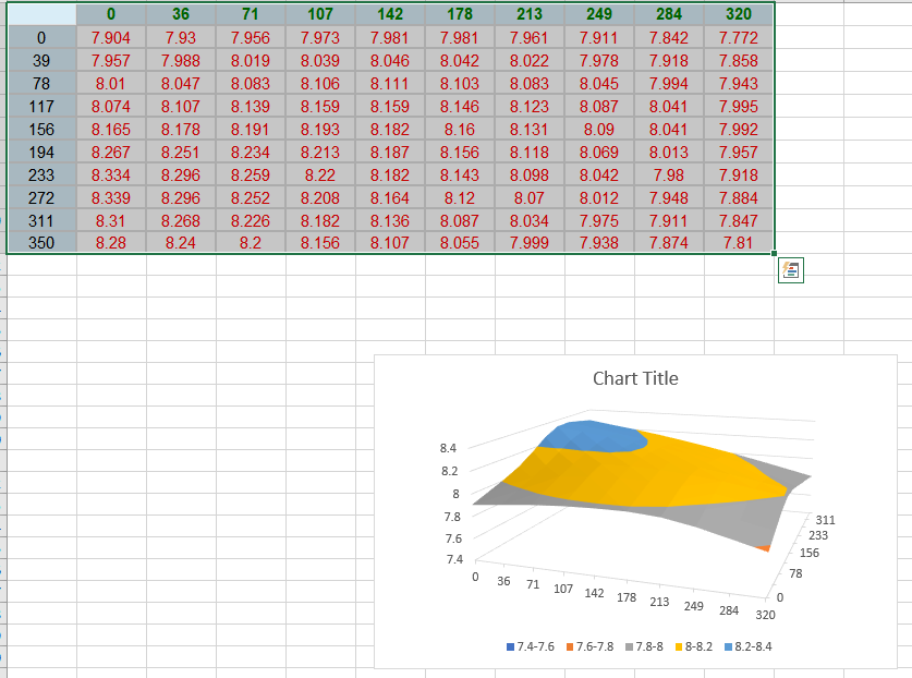

I couldn’t get the plugin to graph the data, but it did store is so I’ve used excel.
MetalOnly 21C
MetalOnly 65C (30minutes)
GlassMental 65C (30 minutes)
I held the glass down with two binder clip. You can see that it is obviously deflecting around the peak and flattening it a bit, but the clips are causing it to flex.
I’m regenerating the GlassMetal 65C as I don’t believe the data. It should have been a larger offset when I put the 1/8" glass on there.
GlassMetal 65C
GlassMetal 21C

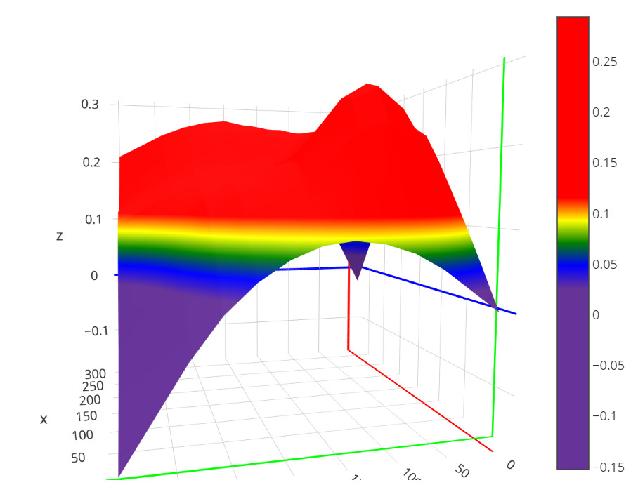

after shimming between the cradle and the heater board, then with the glass on top with the metal plate this is what I’ve achieved. All at 25C
I only use the “M420 V” command for the bed visualizer plugin. (I just use it to visualize the bed, not to level it.
You’ll might need to use the release candidate of the plugin as with the glass in between you’re above 10mm of the zero point and it didn’t support double digit numbers until recently. (See For all who want level on glass - #31 by stefix and [BUG]: mesh data with points with more than single digits doesn't collect data. · Issue #352 · jneilliii/OctoPrint-BedLevelVisualizer · GitHub)
Your bed actually looks quite good. Even before the shimming. it was a fairly straight slope.
Did you tram your snapmaker? That might also help to get things more level. But right now I thinkg that looks pretty good. What’s the max deviation after the shimming?

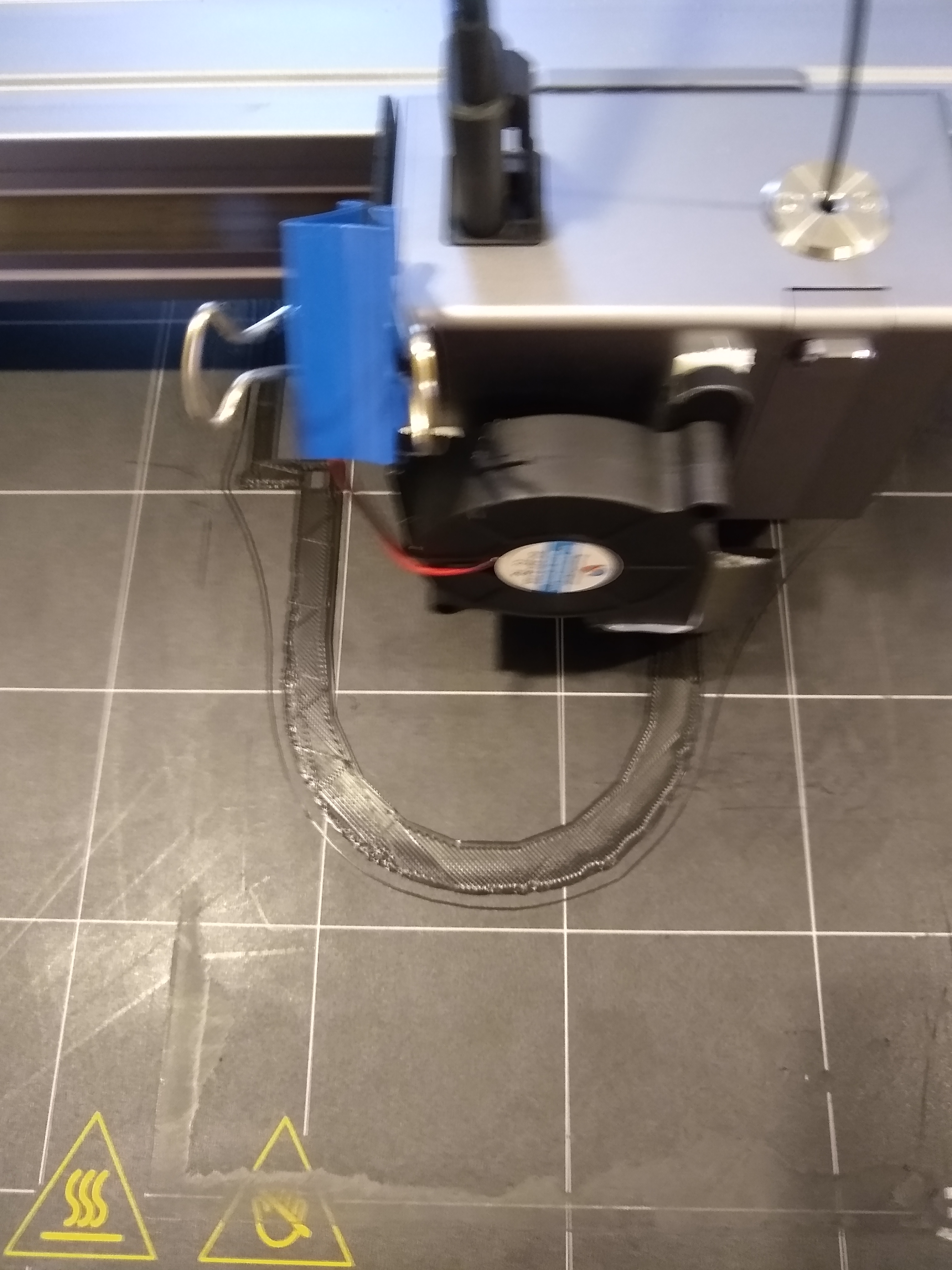

I am with @xchrisd what’s going with that boundary layer?!?!
Did 3D PrintedLandscape give you an STL or GCODE? It just looks all wrong.
Do you have the same problem printing something big but basic, say a bunch of 20x20mm blocks over a large part of the bed? What slicer if relevant. This looks like a model/slicer problem, not a printer problem.
By the way to get OctoPrint Bed Visualiser to show a level you need to tick “Use Relative Z Offset” and it with offset all values to 0 or put your lowest whole number and highest whole number Z value in the Graph Z-Limits.
I did finally find the “Use Relative Z Offset” switch and it started working.

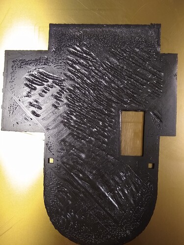

The perimeter looked good, but when the infill/base started it wrinkled up again.
I changed my slicing parameters to the Luban PLA Fast setting. I’ve used this before and it worked OK, but this is my first time with the hatchbox brand.

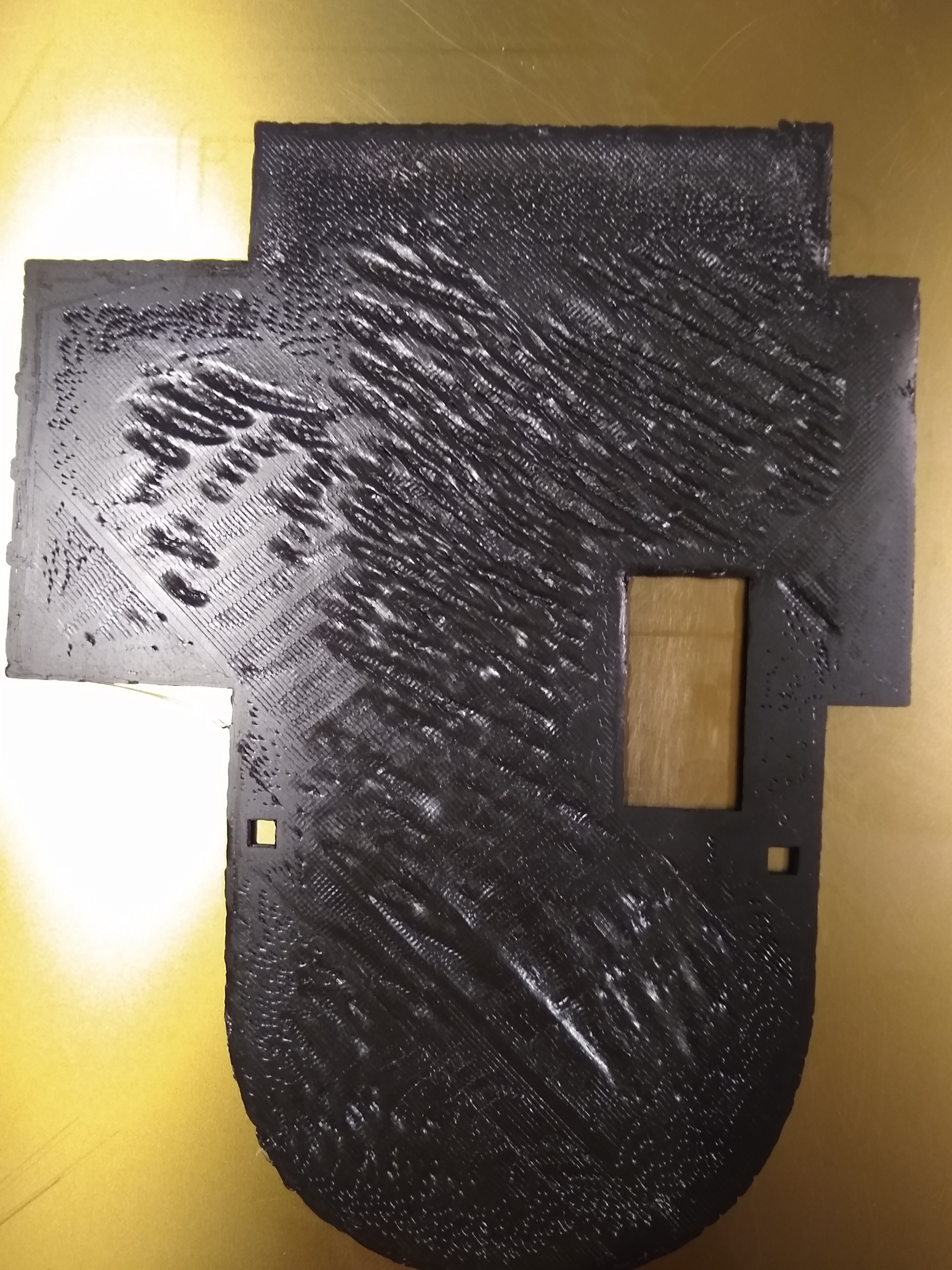

Here is a picture of the print I tried last night after the leveling.
Top View:
Bottom View
It still wrinkled. I’ve never seen this before. Even the “good” areas have bubble holes. It does make se wonder if the hatchbox PLA was wet, but it came from a brand new sealed package.

I think the filament is indeed the most logical thing to look at. Do you have the same problem with other filament? Have you printed something else successfully with this roll?
Also, try a temp-tower to validate 200 is the best temperature.
I added this roll part-way through a previous print. That print finished fine. I have not printed anything from start with this roll. I’m starting a different print with this roll right now to see how it works.
I’ll look to drying out this roll if it still acts up.

these things still just look like wet filament/partial clog issues to me.
i would say the majority of fresh brand new rolls i unseal still could use some dehydration. even the real good shit like matterhackers can be a bit damp on opening sometimes.
bake your spool, swap your nozzle and try it.
also, treat yourself to some matterhackers build series pla, it prints like a dream. like you dont even know what you are missing.
hatchbox may be an acceptable filament, but some of these filaments on amazon seem like they are decent until you realize that they are screwing your nozzle up. the nozzle thing is so complicated and can do so many goofy things.
