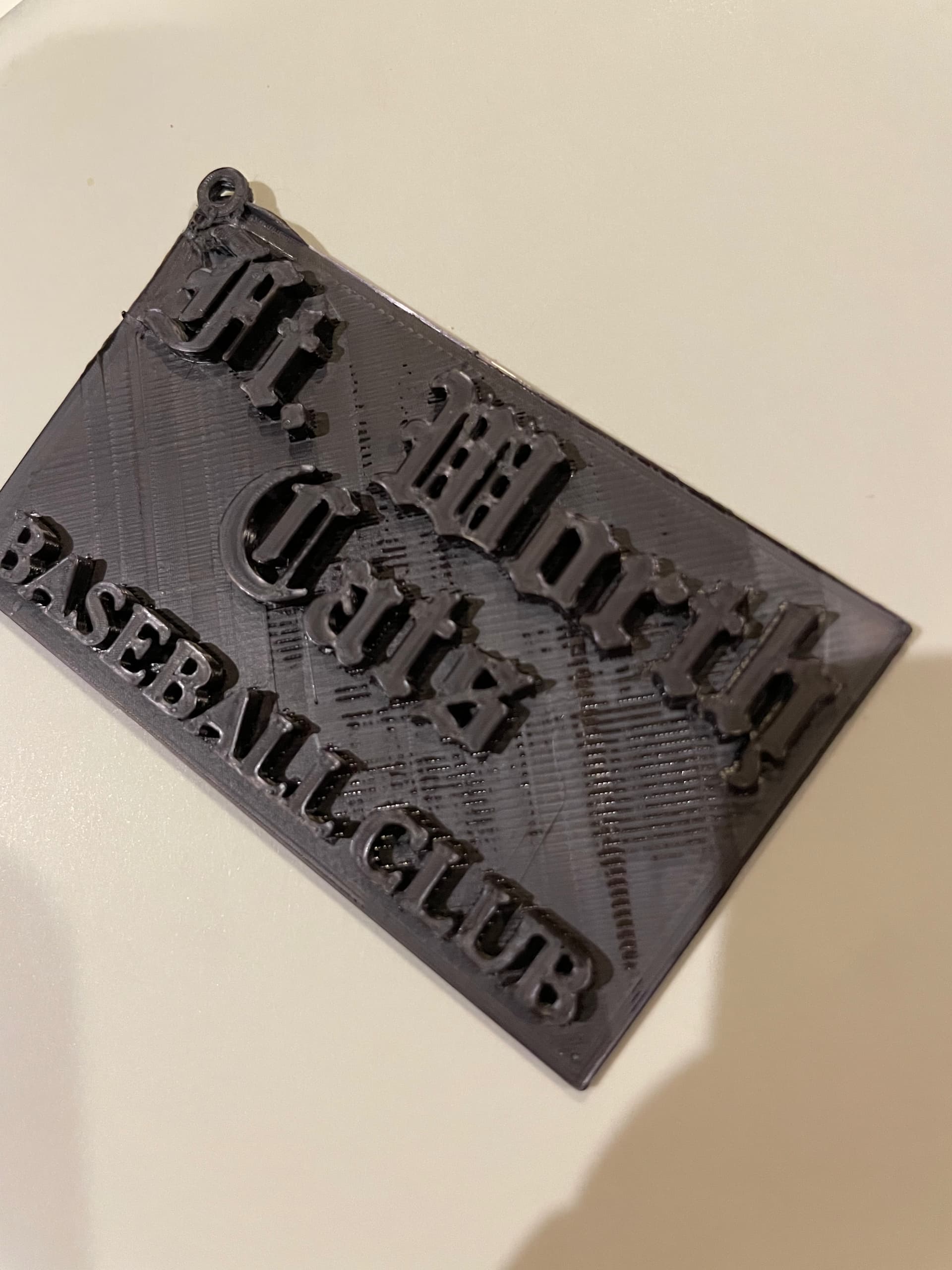

How can I make this look better?

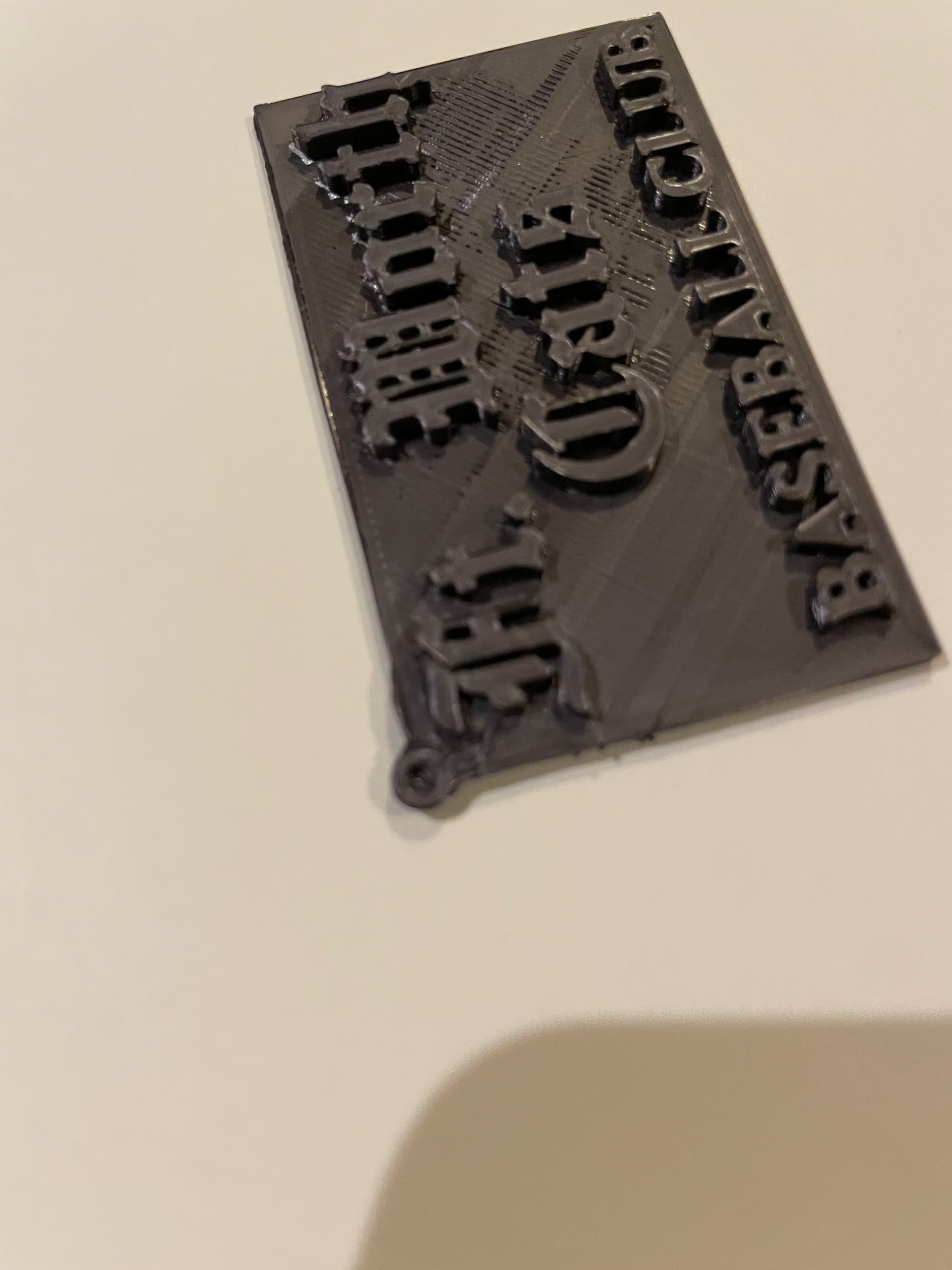

This is a tag that I made for my son’s baseball bag….as you can see the hole for the keychain didn’t print very well and there are many lines visible in the solid portion. Any suggestions for settings tweaking that would make this look better? I used default settings to see how it would print.
Calibrate your extruder and see if you are happier then:
With fdm printing there will be visible lines but there should be no holes.
I did the E calibration. It was under-extruding by 8 mm. I’m redoing the same print now to see if it’s better.
Be sure that your filament could be pulled easily, grinded filament because of too much pull force has a similar print behaviour.
