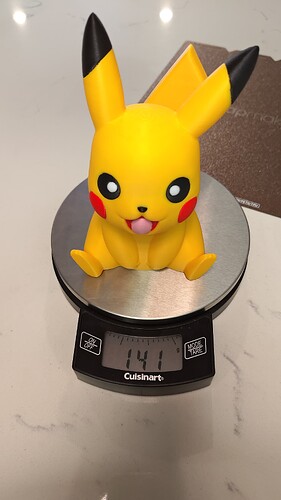

Q: Can you print 6 colors on the U1?
A: Yes! Depending* on the model… Behold, my 6 color Pikachu!
*The trick refers to pausing a print to swap spool(s) mid-print. And yep, it works.
Here I took the suggested model Pokemon-Pikachu (NO SUPPORT) from MakerWorld:
https://makerworld.com/en/models/50835-pokemon-pikachu-no-support
For the unfamiliar, in SM Orca, four colors were painted (yellow, red, black, and white). By right clicking on the timeline, I added a Pause command just below his nose.
Then to start the print, brown is first loaded into black, and pink in for white. When the printer paused halfway through the print, I unloaded the brown and pink and loaded the black and white, then resumed printing.
Using the 1 pause to change 2 colors, we printed a 160 mm tall, 6 color Pikachu in about 5h 45m all together, including the pause to swap two spools. A 141g model with only 24g of waste.
All weirdness around edges had to do with me not being perfect at painting. :sweat_smile:
And no you can’t have Pikachu. He’s going to my niece. :winking_face_with_tongue:

Great post. A lot of people will appreciate that the U1 can actually print five, six or even seven colors via pausing and swapping filament l. Of course it’s model dependent, but still very useful, especially when using Hueforge like in my case.
Yeah. And for a tool changer that, depending on the model, you may only need to pause once rather than multiple times. Since you can swap out multiple colors at once then walk away again. If you’re clever with how it’s painted
It’s a neat trick to stretch the capability a little further! Depending on the model, of course.
For sure this is expected capability, but it’s cool to see it in action.
