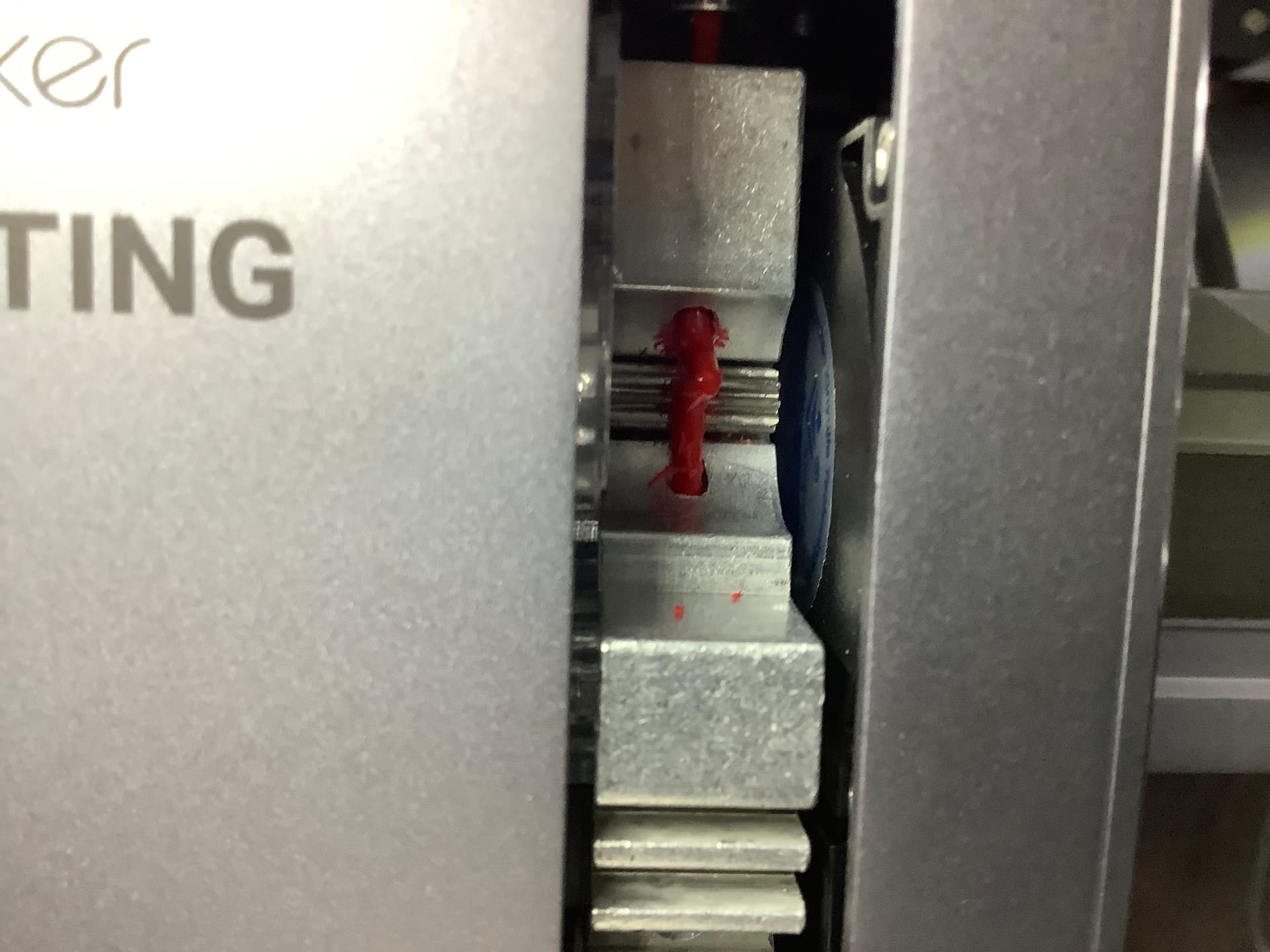

This week I was printing perfect. This morning I changed my PLA spool to a new one from other company.
The filament keeps jamming in the extruder after 30min-2h of starting the print. It already did 4 times. I reduced the retraction and modified temperatures to no avail.
If I open the door of the extruder I can see the filament has become twisted and stuck at the entrance of the hotend. If I cut the filament just before the twist y can easily extract the filament in the hotend with pliers.
The nozzle is not clogged, if I push filament it goes easy and I can see the fused material exiting the nozzle.
These pictures show what I see when I open the print head door and when I pull a bit the filament (you can better see the ‘knot’).
This looks like you’ve got some heat creep happening, the PTFE tube in your hotend could be damaged.
Have you tried replacing the hotend? A spare came with the machine, and it’s easy to replace. I’d try if that works first.
I think I solved it. After 5-6 frustrating failures (always the same symptoms) using different parameters, I found the right conditions. Now it’s almost 24 hours at work.
What solved the problem was to lower the temperature of the print head to 200 ºC.
It appears that the heat from the nozzle block softened the filament prior to entry into the block. Although the filament specifications indicate a working temperature of 195-220, at 205 ºC the problem already appeared. Probably the fact of being in the enclosure and with a high temperature of the bed (60 ºC) was producing temperature conditions higher than expected.
This was with the original SM2 printhead. I think the biggest ventilation in the new version is to avoid this problem.
I’ve just encountered the same problem. I believe in my case the failure was due to excessive heat build-up in the enclosure. I intentionally had my enclosure sealed up to prevent warping of a fairly large model I was printing with PPLA, but after a couple of filament jams every few hours, I left the enclosure open and have been printing without issue for the past 12+ hours.
I do not suggest adjusting nozzle temperature - if the nozzle temp is correct in terms of filament deposition / stringing / etc. it’s probably better to focus on reducing the temperature in the enclosure (or room).

The area of ​​the extruder gearwheel should not get so hot because then the filament softens and can bend before entering the lower block as seen in the photos in my first post.
