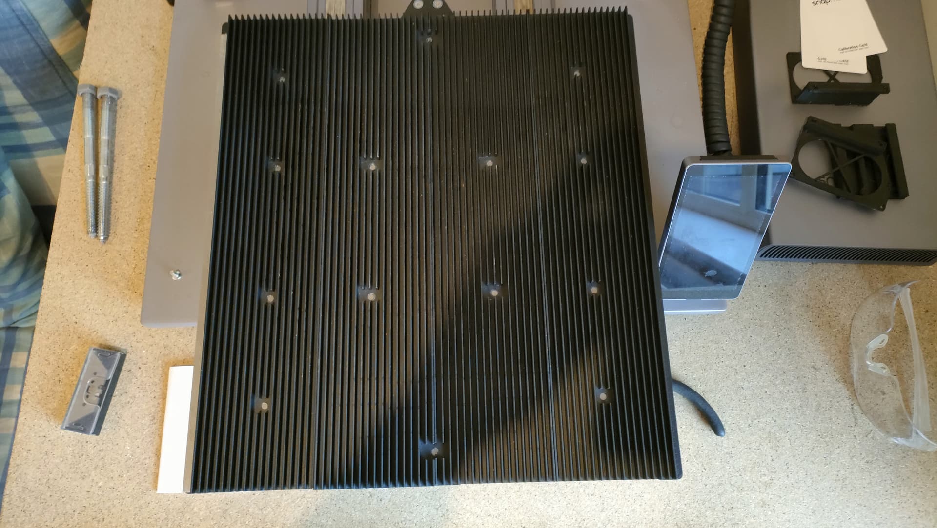

An update on my new setup
I got a sheet of mild steel, don’t use stainless steel as it is not magnetic, cut the same size as the build area of the 3d print 320x350mm by 1mm thick and used double sided tape to hold the laser bed plates on. Make sure there is no tape sitting outside the size of each plate so that there are no gaps between them when assembled.It holds very strongly to the magnets on the heated bed and should not move during work, although I have not tested it yet. Although the laser bed is smaller than the heated bed this is not really a problem as the work origin is set manually for each job.
Below are some images.
The same idea may work for holding the CNC board down but I’ve not gone that route as the laterial cutting forces may cause the bed to slip on the magnets.
Hope this helps.
