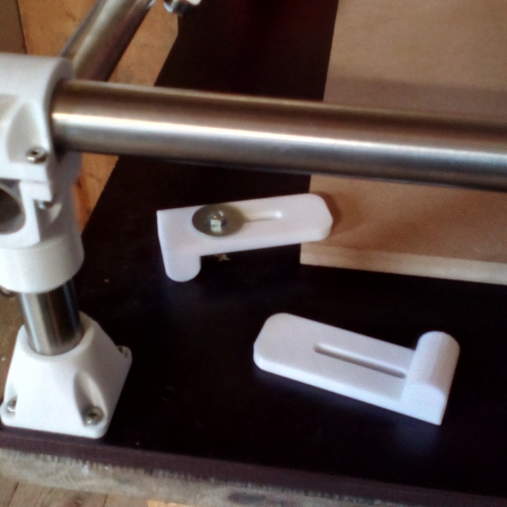

Can you please suggest me a good alternate clamps for my “little” A150?
Hope I receive it soon… :slight_smile:
The clamps I printed were these.
I thought they could work to hold things down and also because of the open strip they could be used to hold material square on the scrap board if I set them with a couple screws (unfortunately that didn’t quite work as the open is just tad shorter than the distance between the screw holes on the A350 board)
Had good success with this: https://www.thingiverse.com/thing:2127535
Great thing is that if the tool runs into it it doesn’t matter.
Work both to clamp down on top as well as just surround the item.
The original was a little big sometimes so I made some smaller versions,
I’m trying to post a remix on Thingiverse but getting a 404 error when I do.
So I’ll post them here (these are in addition to ones on thingiverse). I mix and match all 3 depending on how far item is from any of the screw holes. I’ve built them out of both PLA & PETG.
Clamp_3:4.stl (47.2 KB) Clamp_wedge_half.stl (33.9 KB) Clamp_runt_half.stl (43.5 KB) Clamp_half.stl (63.8 KB)
-S.
Is the slot in that clamp long enough to span two holes on the snapmaker scrapboard?
You mean to have two screws in the clamp at the same time?
Yes, helps to ensure that the material remains square to the board. I’ve had issues where when I’m clearing a lot of material that the torque applied to the board caused it to rotate quite a bit.
Also, I’ve done a couple of pieces where the wood I’m working on is longer than the bed and I needed to shift the wood to finish the piece and a clamp that’s squared to the material makes it easier to move the wood forward/back and not shift it left/right.
I’ve never had a problem with these using one screw and that’s even when I tried going cross grain on oak with a 1/4" bit and 2mm step-down. (Didn’t really go well-just a bit of deflection. :roll_eyes:)
I do sometimes use a couple on the sides at the bottom along with on top edges to make sure the workpiece doesn’t move.
The original one’s slot is 75mm can use two screws diagonally (just barely).

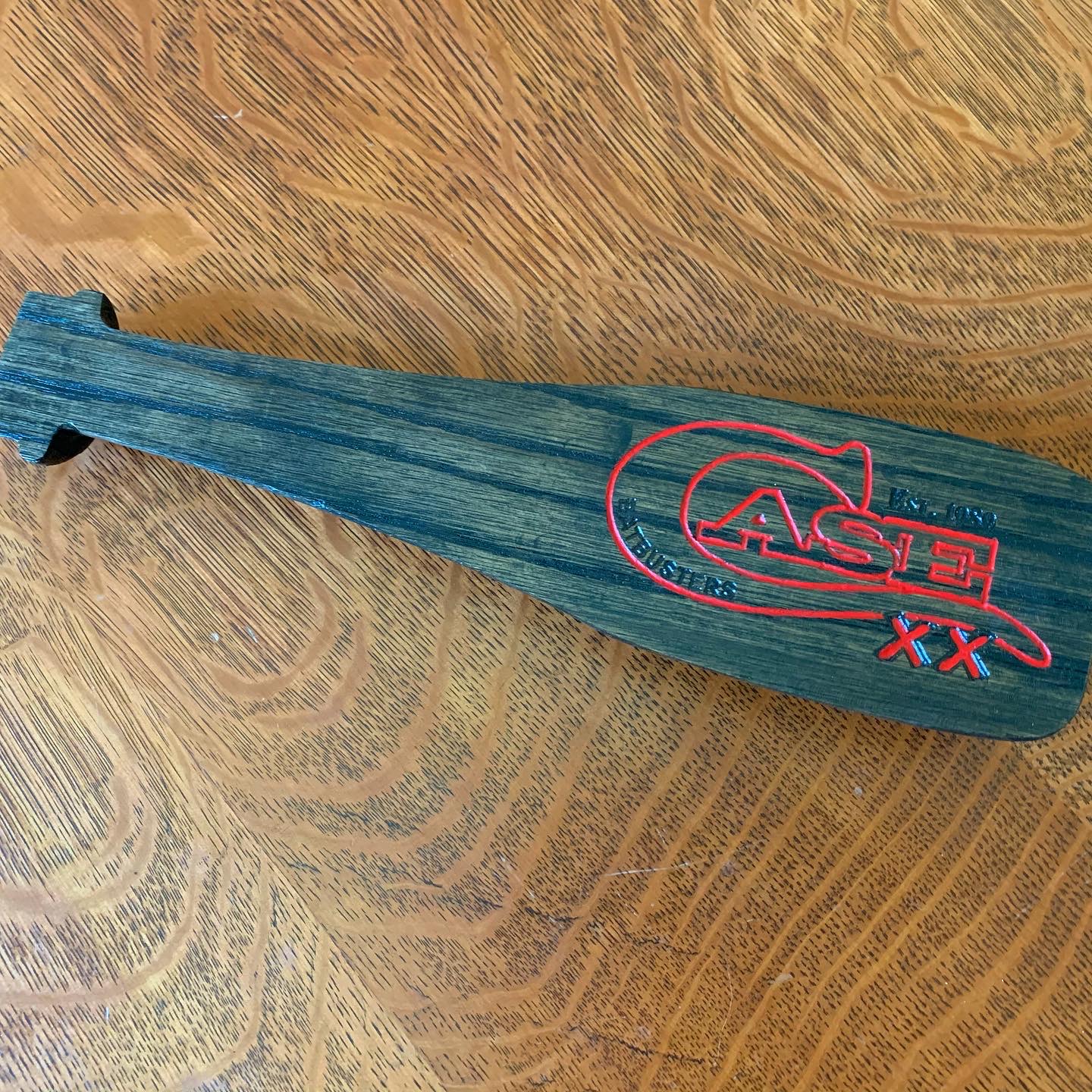

Tape ain’t gonna cut it for some of the pieces I’ve been doing.
I actually had to mill a cradle and use earthquake straps to hold it down to engrave the logo.
