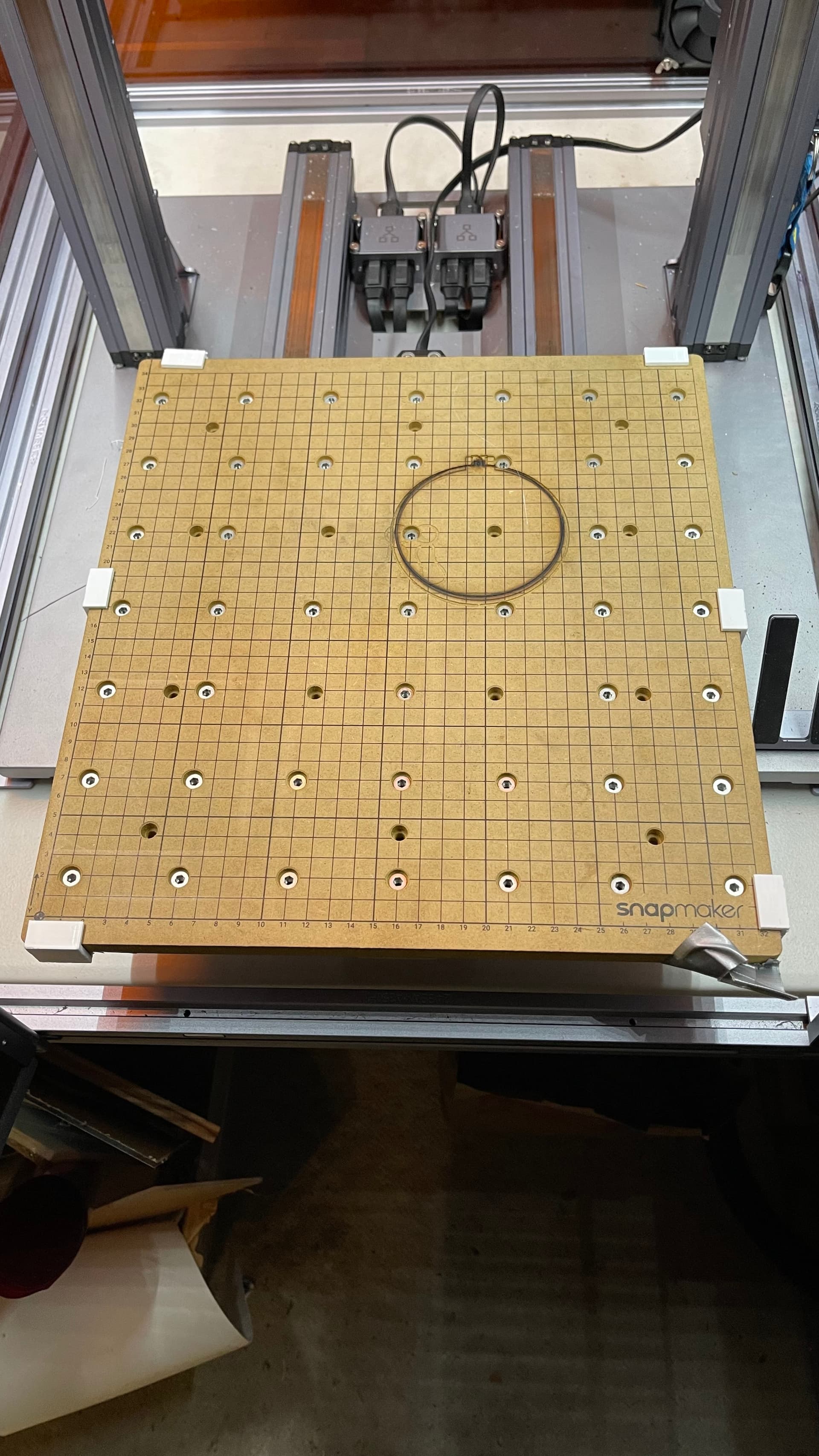

I bought the above magnetic tape and tried various layouts for it under the CNC bed, but while it held OK for lateral forces, the board still rotated easily.
I decided to print some clamps to attach the CNC board to the 3D print board. I added some duct take to the bottom of the CNC board to give it some grip. With that they work. Can’t even get bed to budge.
Here is the CAD file (in OnShape)

The magnets do not work… Use 3D printed clamps

For me they have been working very well so far. Also for cnc work. But I am using 4 pretty strong ones (if I remember correctly they can hold more than 20kg each). And I have printed “cups” for them and the metal counter plate so they automatically align perfectly and can’t shift sideways (which takes a lot less force)
Yeah, a pocket or shoulder of some sort would have prevented the lateral movement. I won’t lie: it was an entirely half-assed attempt to hold the 300x300 glass print plate in place using a steel frame with neodesium magnets to supplement the not-really-strong heated bed. I used screws instead, and will probably use screws again in the final verson. Good, honest screws. Well, not those grade-2 ones at the hardware store that shear when you attempt to loosen them: those are less than honest.
