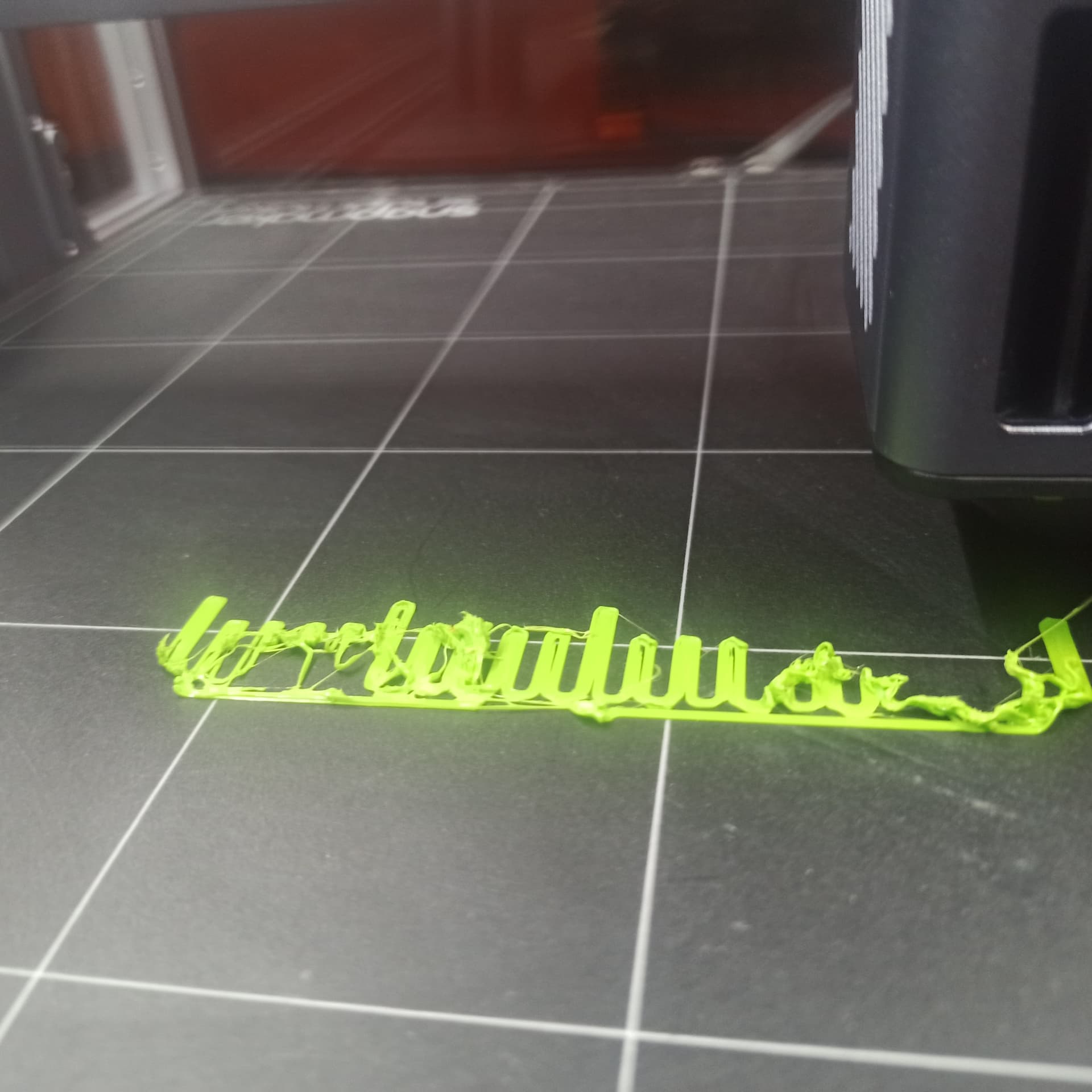

Same problem here. It looks like the z value is wrong. I got an answer from support to calibrate the sensor. But how do I do it on the dual head?
Probably a different issue - mine is related to switching from one to the other, yours just looks like bad adhesion for the first layer? You can go into Calibration and choose to calibrate z heights there, can’t remember what it is called because I haven’t used it since.

I havent come soo far that I can choose from the menue, it wants to do the full calibration…
Sorry mate, I finally got it to print using black PLA and the supplied breakaway. You might have to start the whole process from scratch - turn off and turn back on again. If things still don’t work then let it do the calibration prints as bad as they are, accept whatever result it gives, then it should give you access to the calibration menu. You can redo everything from there (including those XY calibration prints)
