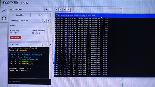

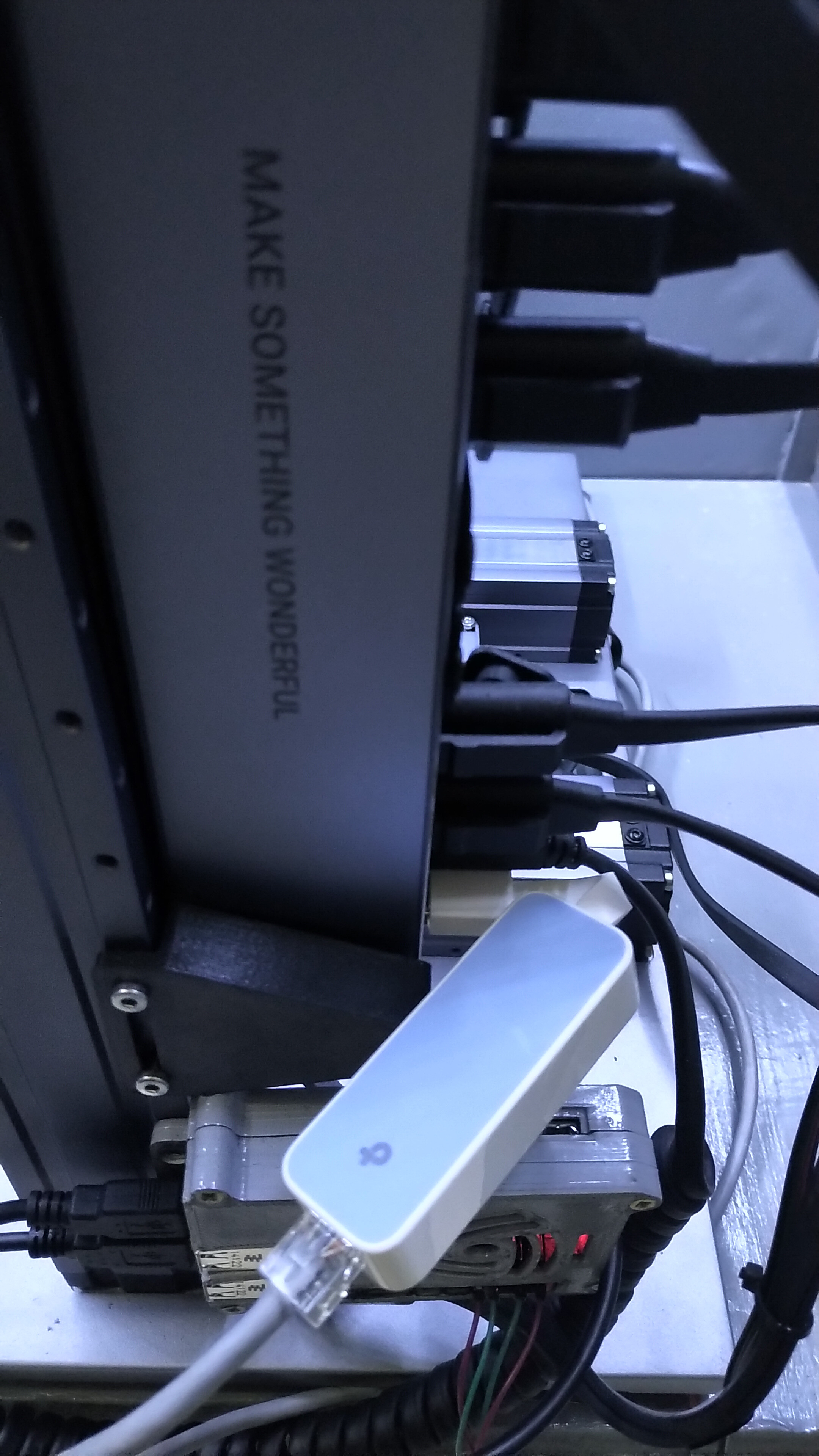

Connecting the Snapmaker A350 over a local network
I will not describe for a long time why and why I do this. The main thing works and the goal is achieved.

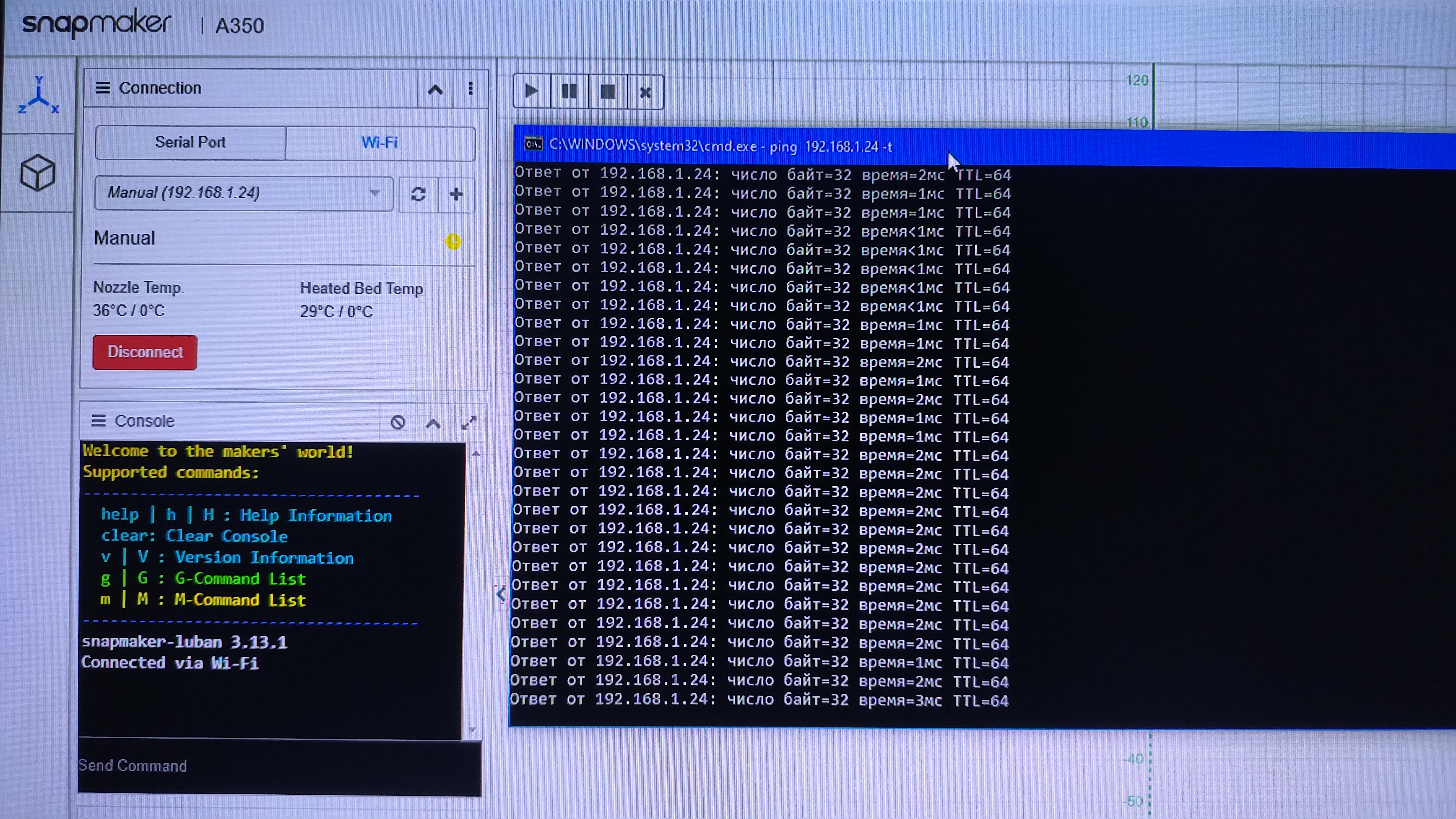

It works much more stable than WI-FI, there are no connection breaks.
The distance to the printer is about 30 meters. In a complex urban environment with a large number of wi fi networks in the 2.4 band
Very nice.
That’s in the USB-A socket, the bottom one (normally used for the USB thumb drive) right?
Ah, he is using it as an ethernet adaptor eh? Hmm interesting.
I was gona install a USB to Ethernet Cable pair to run ethernet cable to my computer in the other room for direct connect via the USB mini (as the USB range is significantly smaller than ethernet so this is a valid method), maybe that isnt necessary if the machine is accepting the ethernet connection from the USB adaptor

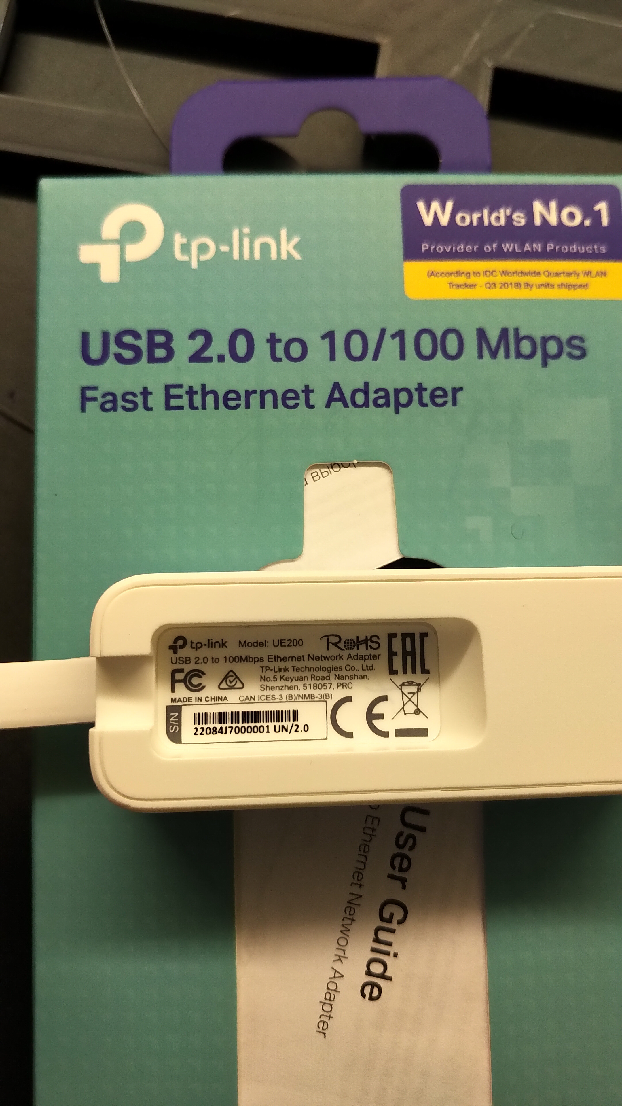

Check out this post about using an ethernet adaptor:
https://forum.snapmaker.com/t/works-usb-to-ethernet-adapter/8074
