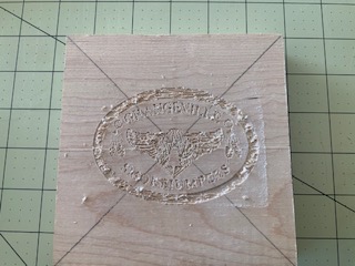

Any suggestions to make this cleaner?
Which bit did you use? You can use the flat end mill bit to mill the outer circle and use v-bit to carve fonts and the image in the center. But you’ll need to make two files and work on the wood twice.

Tools Bit mention above make sense. But also I think the grain of the wood , looks to me that is plywood.
also , do not go to deep at once , make sure your feed and speed.
think about the areas of your design. cavities , 3d shape etc. hard to see with the picture.

What are your settings? What bits are you using?
First thing to check is that your density is set to the highest (10)
