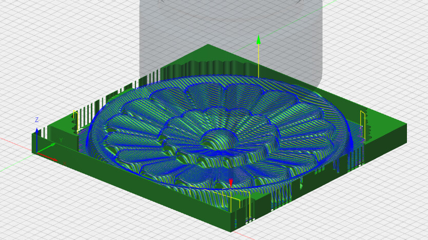

for the first time I tried the image-to-surface add-in for a grey scaled picture in FUSION 360 to try a wooden relief.
The simulation in 360 showed me that everything would be fine , toolpath seemed to be ok.
After post-processing I put the .cnc file on the usb stick and plugged into the A350.
After homing, setting up table height and adjusting work-origin I started the process.
To my surprise the tool started working above the material surface and didn´t go inside.
It seems that there was something wrong with Z.
Looking into the gcode file with an editor I only found positive Z values.
In comparison a gcode for another wooden relief generated in LUBAN showed always negative values for Z axis how it should be.
I have no idea how to get negative values from 360, because if you invert Z , of course X and Y also change direction.
Does anybody knows what happened.
You probably didn’t set your work-origin in fusion and on the SM in the same place.
(you did configure Fusion with the Snapmaker postprocessor?)
It is possible to set the work origin in fusion at the stock bottom or bed level rather than stock or model top and if you have no negative values this sounds likely. In this case you will never get a minus value as all of the GCODE instructions are absolute values referenced from the work origin.
thank you, as you can see, in Fusion the origin is lower left corner and on the build plate it is lower left plus material thickness. (means upper left)

it made the whole Z-step in one pass, I couldn´t find the option to select multiple passes in FUSION
Yes thats what I would do. Make sure you set it on the stock top. When setting any CNC job you move the end of the bit to that position and tell the machine in Luban or through the console that its the work origin. Where it is now you cant get the end of the bit to that position. I find best place is either Stock top bottom left or stock to centre depending on what’s easiest.

so with your help I`m a step further.
Seems that I was struggling about the german translation for the check boxes.
But now I have the next problem and I´m wondering if this is logical.
If I choose one pass , I will get this simulated toolpath:
and if I choose multiple pass , then I get this one.
I don´t understand ,because negative steps are not permitted.
any idea ?
Uhm, that looks awkward. It looks like it’s moving in the air a lot of the time.
short: for detailed help, you will probably get more feedback from the forums specifically on Fusion360 (https://forums.autodesk.com/t5/fusion-360/ct-p/1234)
The best advice I can give you is to use 2 toolpaths:
  • first do adaptive clearing and check the box to leave .5mm stock (this is way more efficient for initial roughing)
  • do a second step with the parallel toolpath (or another one)
But start with adaptive clearing first.
You don’t have to change bits for different paths and if you select them both when generating the toolpath, they will be combined in a single gcode file as well.
ok, thanks a lot, seems that I have to dive a little bit deeper into fusion, cause LUBAN has a strange behaviour too
