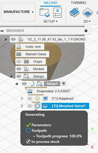

Thank you all for the suggestion that I use Fusion 360. However, now I have Fusion related questions. I now have an error in the second Tool Path setup where I am stuck. The Parameters are set, and the Tool path progress is 100% but it is stuck and the final Stock is still In Process. I cannot run a simulation because it says the Toolpath is still generating. But the program has been stuck for 4 hours so far.
You are all correct, the learning curve for Fusion is very steep. However, a very nice Mr. Rodney Shank made a very detailed review of the process for setting up initial Rough Tool Paths then the fine tool path (https://www.youtube.com/watch?v=TfqBKqzxl44 ). Although this tutorial is for a slightly older version of Fusion 360. The Current Autodesk Fusion is very similar. However, for my second detailed Tool Path, I get this stuck error.
I am not sure what to do at this point. Has anyone come across this problem and have a solution?
I have had similar situations several times, and never worked out where exactly the problem lies. Sometimes I played with some parameters, and suddenly it worked, sometimes I gave up and used a different toolpath. Fusion is one of the few pieces of software where you find me cursing out loud in front of my computer… My life saver was Lars Christensen: https://www.youtube.com/watch?v=A5bc9c3S12g&list=PL40d7srwyc_PUk-XisDh54N-hVtLg5p6u
Morphed spiral takes a long time to generate. Though four hours seems a bit excessive. Also, I always found adaptive clearing also takes a long time. Basic 3d pocket clearing seems to be fastest and work best for me for the roughing. It might just be where the adaptive is also intensive, it’s recalculating everything and locking up. Try using a 3D pocket rough and a morphed spiral finish.
