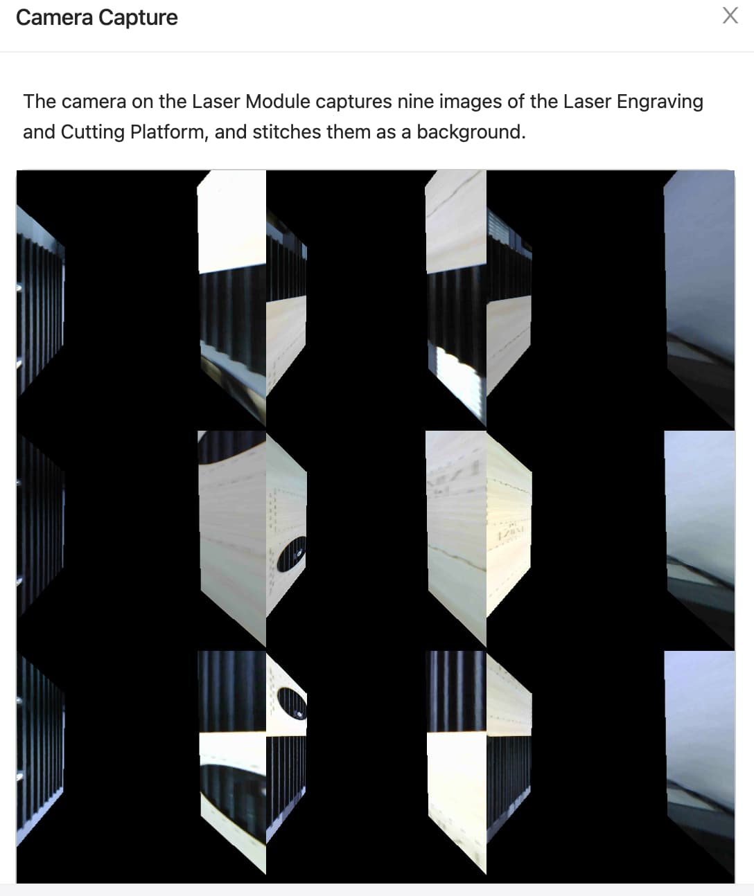

I have run the camera calibration several times and this is what I get. I can’t figure out what the heck is going on. There is a square sheet of bass on the plate when the capture is done.
I did notice when running the calibration, the laster does not cut a complete square. There is a gap at each corner. Is that normal or is that perhaps part of the problem?
Is the laser module defective?
Any assistance is greatly appreciated!
Jonathan
The gaps are ok and your picture is ok. All you have to do is to click on ‘Calibrate’ and put the lines exactly over the square.
Look at the manual point 4.8 Camera Capture
Oh geez. I totally missed that. I’ll give that a try. Thank you.
