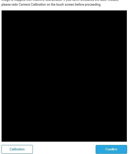

was able to calibrate the Laser module, can connect using wifi, everything green on the touch screen, enclosure leds are on, but only black tiles. Any suggestions?

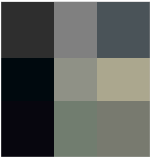

Has anyone from Snapmaker gotten back to you about this as I am having similar issues, but they are multi-colored squares.
I had calibrated and everything looked good. Then I went to updating the firmware and Luban software. After all was successful, I went to run the camera capture and I got this below:
Looks like I figured it out. You need manually recalibrate by pressing “calibration” then follow the instructions to align the points to the corners of the calibration picture. After confirming, it will auto load the camera capture and you will see the stitched image…
