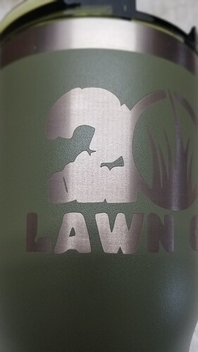

I am having issues of vertical lines appearing when engraving powder coated tumblers with rotary and Luban. They appear to be consistent when they appear with every project but only on left half of graphic. Why would they be vertical when the rotary is operating on horizontal mode.? Have tried varying power up and down but doesn’t change outcome. Speed is 1000mm/min and power from 35% to 45%. Could rotary be the issue or is it a software issue… Any help is greatly appreciated…

10watt and SVG files. It has happened on a few other rotary projects but others turn out great… Attached 2 pics. 1st is after extensive cleaning using GooGone and magic eraser. 2nd is after reducing speed from 1000/min to 800 and increase of power from 40 t0 45%. Very faint but lines still present…

I’m not really seeing what the problem is in those pics, they look pretty good. Have you tried adjusting the Fill Interval for a higher “resolution” burn?
Alternatively, adjust the line direction to Vertical, so that any lines go in the same direction as the finish already on the metal.
Same here - I have difficulties understanding your issue, but after all you said that you already post-processed both results, so perhaps it is less obvious? The fist picture shows some pattern on the lasered parts - to me it looks like residue from the paint treatment or metal preparation - but I have difficulties really telling from the photo. I you happen to have a new, fresh example, please post another photo before you apply any next steps to the job!
Sorry the pics didn’t express what I am seeing better. Tried a higher dpi but didn’t help. At first I thought maybe it was a flaw in the metal the manufacturer used but the lines are consistent on every piece and exactly in the same place and just the left side As far as changing the line direction, I have tried to get it to burn vertically but it doesn’t change no matter the choice. Has been that way since I started using the rotary… Flashed with firmware several times but to no avail.

Can’t see anything wrong.
Are you referring to the steel surface?
It seems all normal to me, it’s like a steel surface could be if it’s not polished.
Talking about the vertical darker bands of equal spacing that only show up on the left side of a project and with the same exact placement on 18 straight burns of same project and others as well…
If it’s not a result of the process of the metal itself, then it looks like it’s caused by an inconsistent rotation speed caused by lumpy bearings, or the drive gear (if there is one) being non-constant-velocity.
Can you share the right side without the vertical lines?
Is the Rotary module rotating equal when you laser this area or is it rotating X degrees, stopping, continuing for X degrees?
