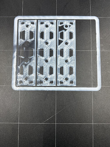

Bad first layer on a350
I keep printing things hoping the first layer will be better, but it always turns out like this.
It appears to me that the Z offset might be too close, and since it’s only happening at the one spot, it could be a leveling issue. If you print it in a different location on the bed or rotate it 90 degrees, is the base layer also bad at the same bed location?
