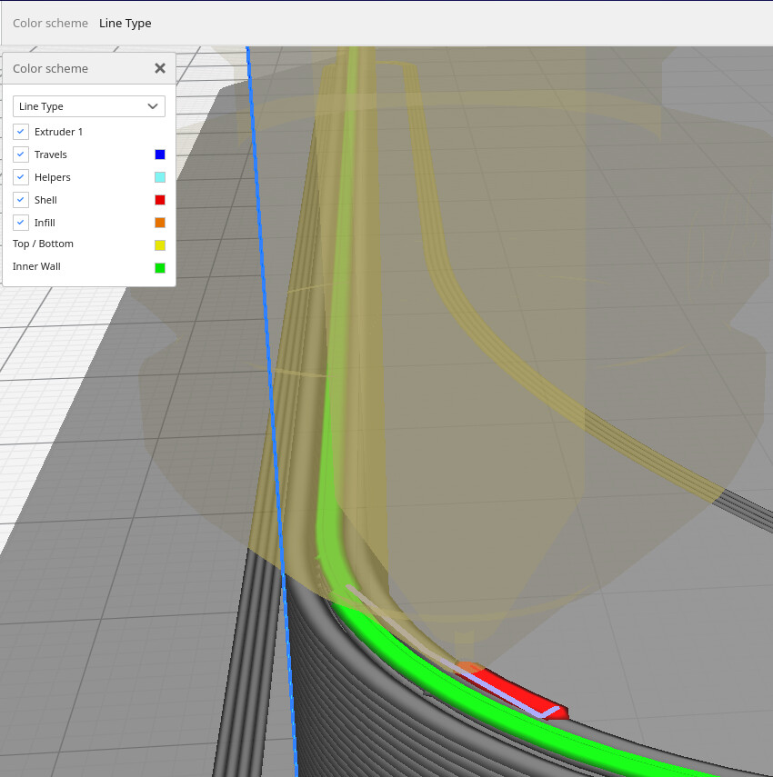

The corners on the inside are all G0 moves with no extrusion. Is the nozzle just travelling somewhere else but refusing to leave the perimeter for ooze reasons? In the preview does it show the inside of the corners and walls hollow? How’s it printing?
ncviewer is kind of hard to view for still like this, and I don’t have S3D in front of me at the moment.

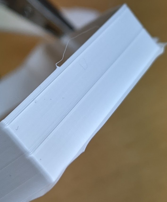

Prints unfortunately with lines. :frowning:
Here is a video and pictures.
I think i know why the g0 moves happen. I’ll try to explain it tomorrow.
Thanks for the video - I think that explains the g0 just fine. Just travelling to a new location to start infill.
There’s no tension on the filament is there - I couldn’t really see where it was feeding from and it seemed loose enough, but couldn’t really see. If it’s binding that could be bad.
I’m wondering if this is a combination of slight over/underextrusion combined with the infill, combined with a slicer/model specific quirk. I wonder what would happen if the infill pattern did not alternate by 90 degrees each layer - I am suspecting due to the geometry the infill is variable from each layer to layer, causing alternating lines.
In Cura the infill angles can be set, would be interesting to use the same infill angle for every layer and see if the lines go away.

Looks like there are two inner walls laying on each other on one layer.
Look at this:
Start:
Inner wall first line 40 mm/s:
Inner wall second line 40 mm/s:
Start outer wall 20 mm/s:
End of layer:

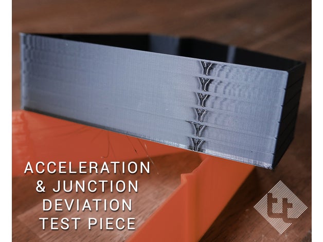

At the moment I’m doing the accelleration and junction test.
Interesting to tell that i never used junction deviation before, but my acceleration is set to 750 mm/s while printing the boxes where I realised this problem.
Alright - I got some interesting results.
At first - did not use se settings recommended in this video.
I set cura to print only the surface, so it only prints the outer wall with 20 mm/s.
I made three prints
First print was with acceleration set to 250, and junction deviation set to 0.01.
The first picture shows a vertical wall:
The first two segments seem okay, no visible line. The third segment has a line which I created by upping the speed to 200%.
The second picture shows the same wall with acceleration at 750 (my default) and junction deviation set to 0.06:
There also are no strong lines.
The third picture shows this wall again, third print - mostly the same parameters, but I changed a small detail that I’ll come to later.
It it seems to be more smooth.
No we come to the horizontal y wall:
Here we have some lines, at the center of the Y.
Now the second print, (acceleration 750, JD 0.06)
The Y looks much better, and the soft lines starting at the center of the Y are visible, too.
I took a look at the gcode preview:
The Z seams are lokated exatly there. So theres a layer change. The cura config corresponding to this says: Locate Z seam on the sharpest corner of the level.
So lets come to the third print again. I set the Z seam manually to 0/0 of the object:
The Y looks a lot better, and the soft lines are gone.

Yeah - I think the problem is solved.
Yesterday I did a print with s3d and most of @brent113 's default settings (sorry, no picture) and the lines were still there, but not as strong as with cura, and there is no JD configured.
Today I did a little more research and made two more test prints with cura.
Number one shows my test wall with JD configured. It looks better than the prints a few posts before!
In the next print I disabled compensate wall overlaps - and tadaaaa…
If I am not wrong soft lines like this are within specification and not weird anymore. Isn’t it? I’m starting to develop printing insecuritys :sweat_smile:
I’d agree with that. Looks good to me.
Than this issue is solved.
@Linui this could be interesting for you, too.
Recap:
Linear advance, Junction deviation, accelleration, flow and speed really made visible differences. But the real problem was created by the cura feature compensate wall overlaps.
I found a few articles that such problems can be caused by this feature - our printer is no ultimaker, so features for this printer doesn’t necessarily have to be suitable for the snapmaker.
It’s enabled by default, so deactivating it might be a good idea.
