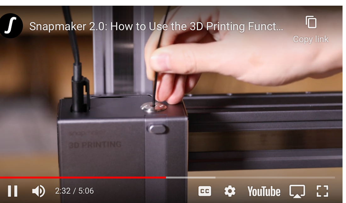

The user guide and video clearly show loading with the door closed:
I’ve had no problems doing it this way. Even TPU without the adapter made it’s way to the heat break fine. It’s only when I push load and it tries to feed to fast that it backed up. Even if I did need to get it started with door open it would still do this.
With the adapter in place I can load TPU with the door closed. In fact I actually have to because it’s a lot easier to install the adapter with the head on it’s back.

  • As for loading the filament, different people may have different methods.
  • You can insert the filament manually when the door is open to make sure the filament is in the hot end kit tube. And then, close the door, tap “Load” on the touchscreen when the nozzle is heated up.
  • You can keep the door closed and then insert the filament into the inlet, and then tap “Load” on the touchscreen.
All in all, the first method would be more convenient to see the filament is in place.
As for the flexible filament, like TPU. You’d better use the first method. Set a relatively slow working speed and extruding speed to avoid the filament from bunching up inside the printing module.
