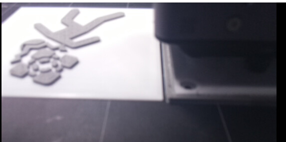

Update for this Topic.
i was wondering that i could not pull the Filament . I took the Hot end out of the machine
i wantet to CT Scan the Module in my Office today but than i have seen that the Filament cannot be pushed or pulled , but its rotating inside.
so i took the plier and with a lot of Force i could pull it out.
End of the Story … Filament baaaad quality …

Meanwhile my bigger Problem is the not flat printbed… i do now the upgrade to a glass surface ( magnetic sheet applied to one side of the Glass + stabilisation rails)
