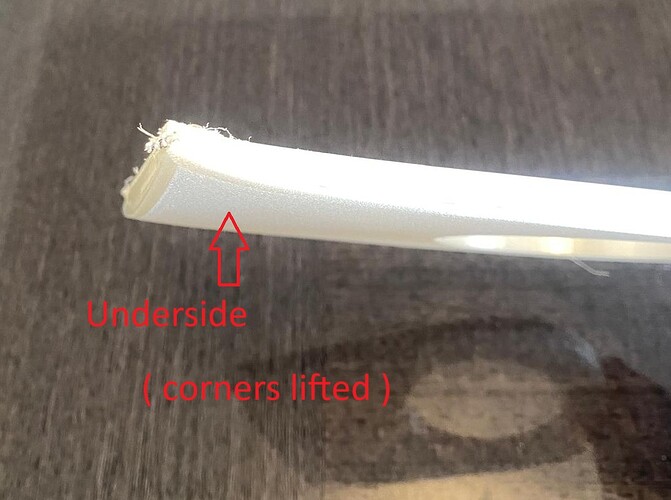

Bed adhesion primary suspect. Did the print get loose in the middle of the print? You might not know post mortem but you can double check bed levelling and perhaps decrease z height a bit and increase bed temp to 70 if you’re printing with PLA. 95 if ABS.

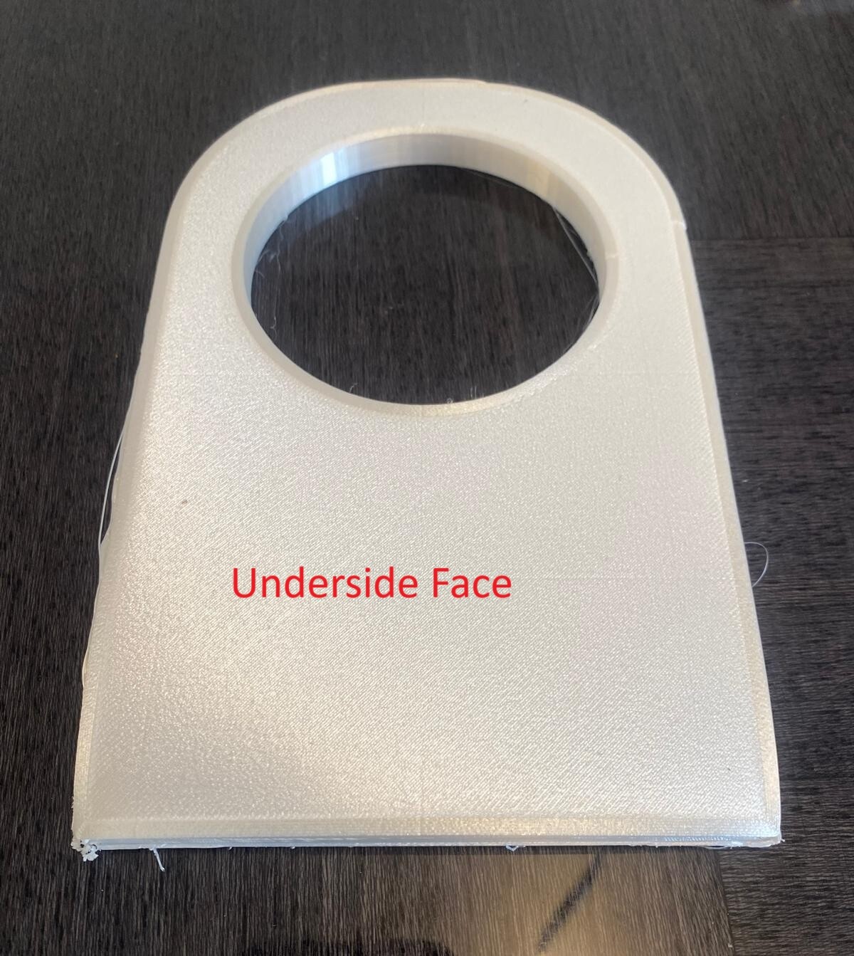

Post a photo of the underside of the print plz
Looks like the stl needs to be repaired? (Exclamation mark in front of model)

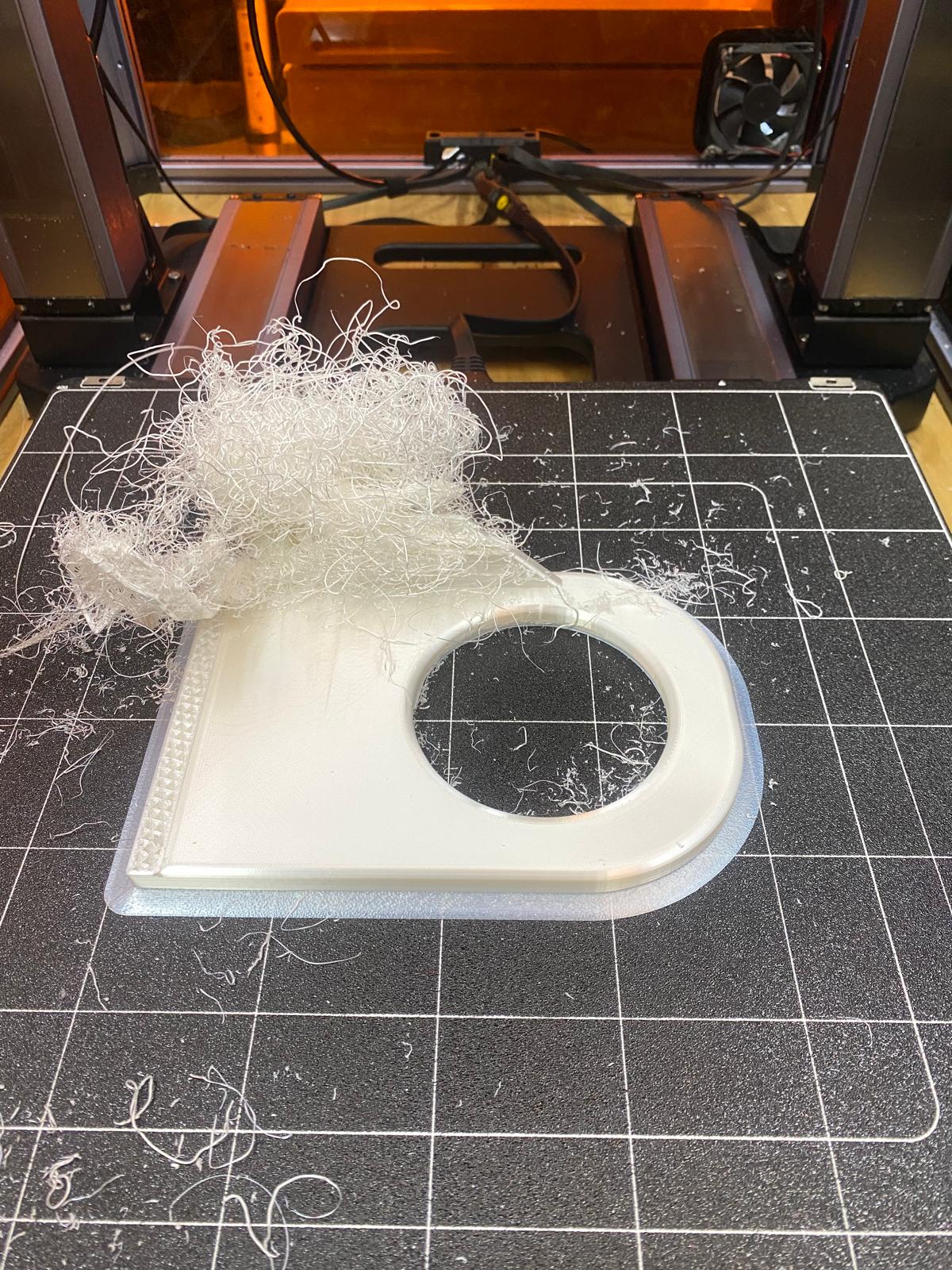

advise. I will try again. Here are some photos

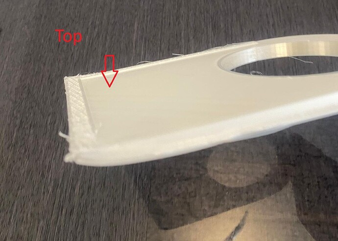

Warping. Increase the bed temp or add a brim.
Also good to heat up the interior in enclosure. And keep door closed.
It’s now clear for me, was the model loose on the build plate?
Exactly.

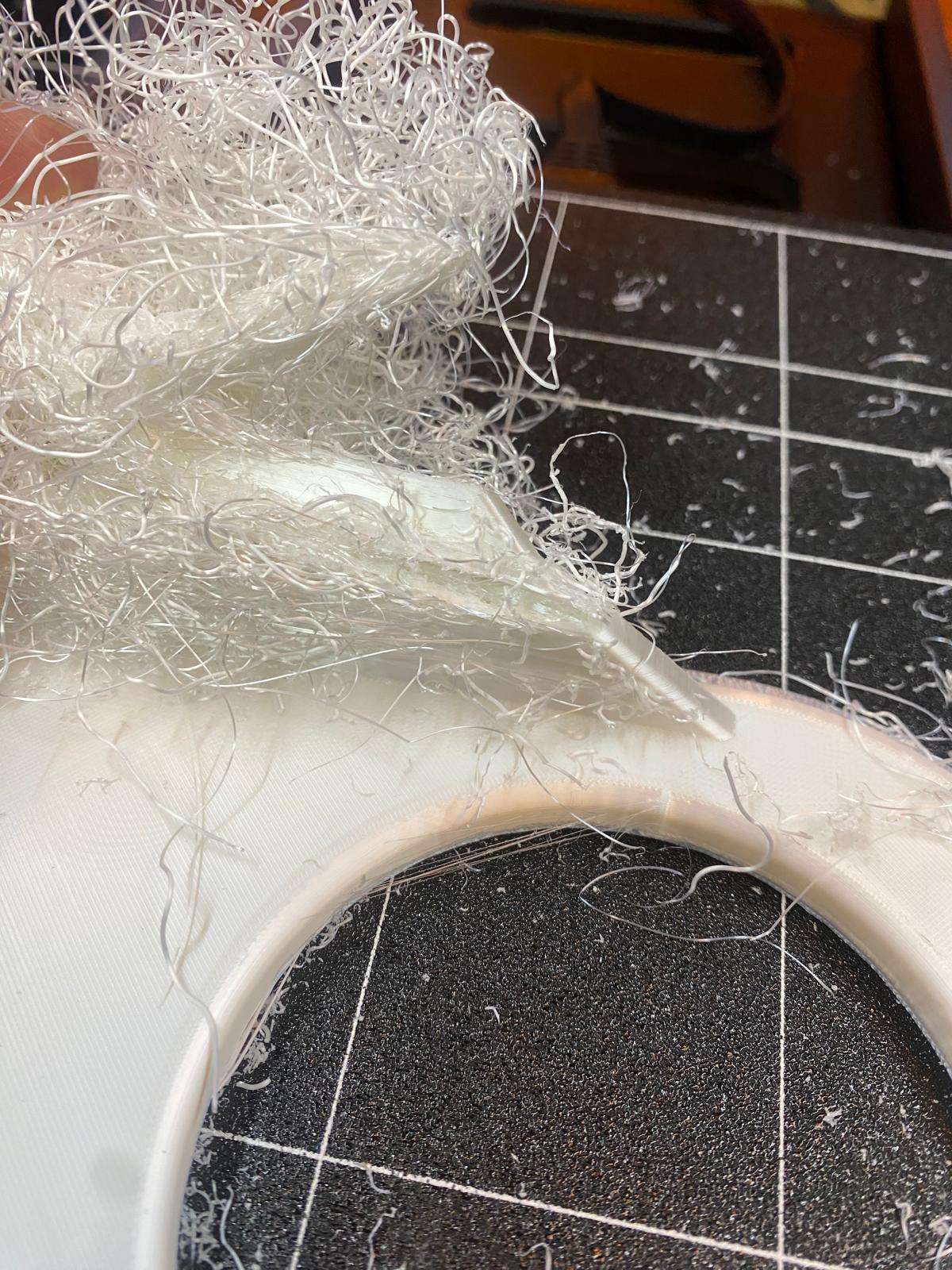

The print didn’t stick to the print bed and got dislodged then the print head started printing in the air producing the spaghetti of filament in the picture.

The model was not loose on the build plate, I did have to prise it away with my scraper tool
Still, warping is clearly there - the advice of the others is sound here - use a brim and raise temp’s. Btw.: What kind of Filament are you using? From the optics I’d guess on ABS, but that may be misleading. ABS is very prone to warping and needs special attention also to print cooling (no first hand experience, just reading what others say).
Even if the model didn’t become loose, warping changes the print dimensions and its location so when the nozzle looks for the previous layer to print over it it doesn’t find it so it prints on air.

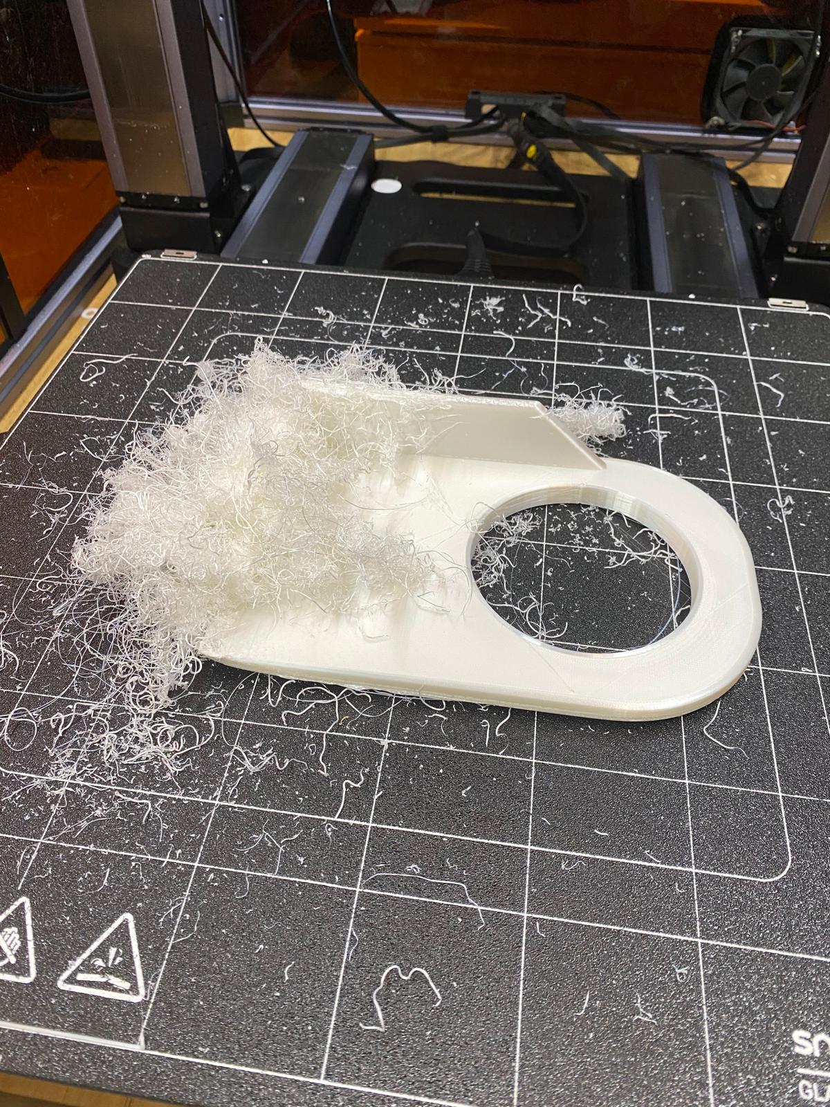

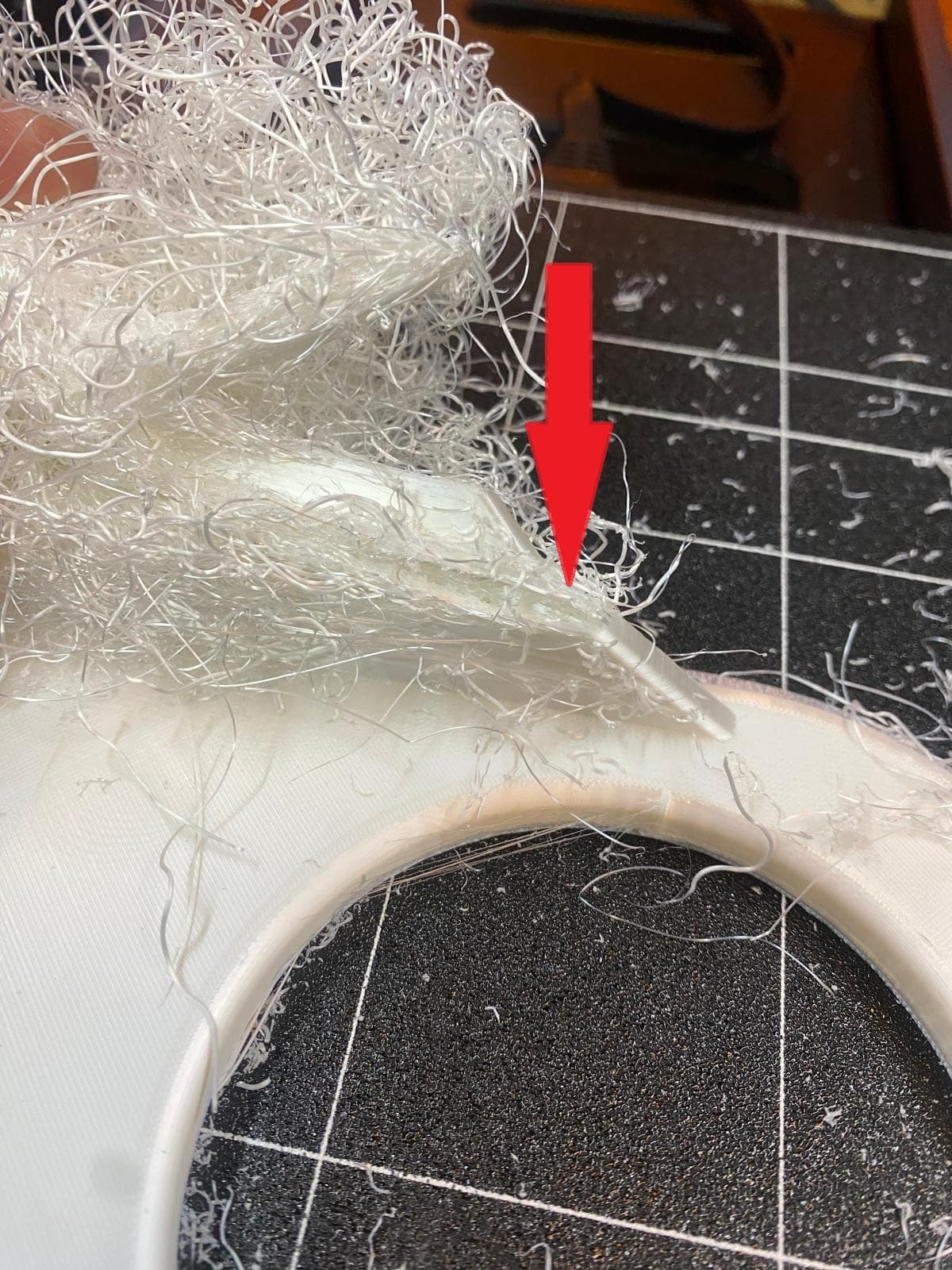

This is the second print after repairing the model, added the brim and increased the bed heat. This has cured the warping issue but fails when printing the side walls.
What happened to the diagonal wall at the front? On your sketch there should be a wall at the front and back. On the print I can only see a smooth top layer.
How well does the rear wall adhere to the base plate? Is it easy to tear off?
I stopped the print mid way after seeing this. There was no rear wall built at all. The diagonal back wall snapped quite easily at the red arrow. I think i’m jumping the gun and not compiling the model properly in Fusion (the STEP file attached is made of individual bodies) and then imported into Luban as a STL file
