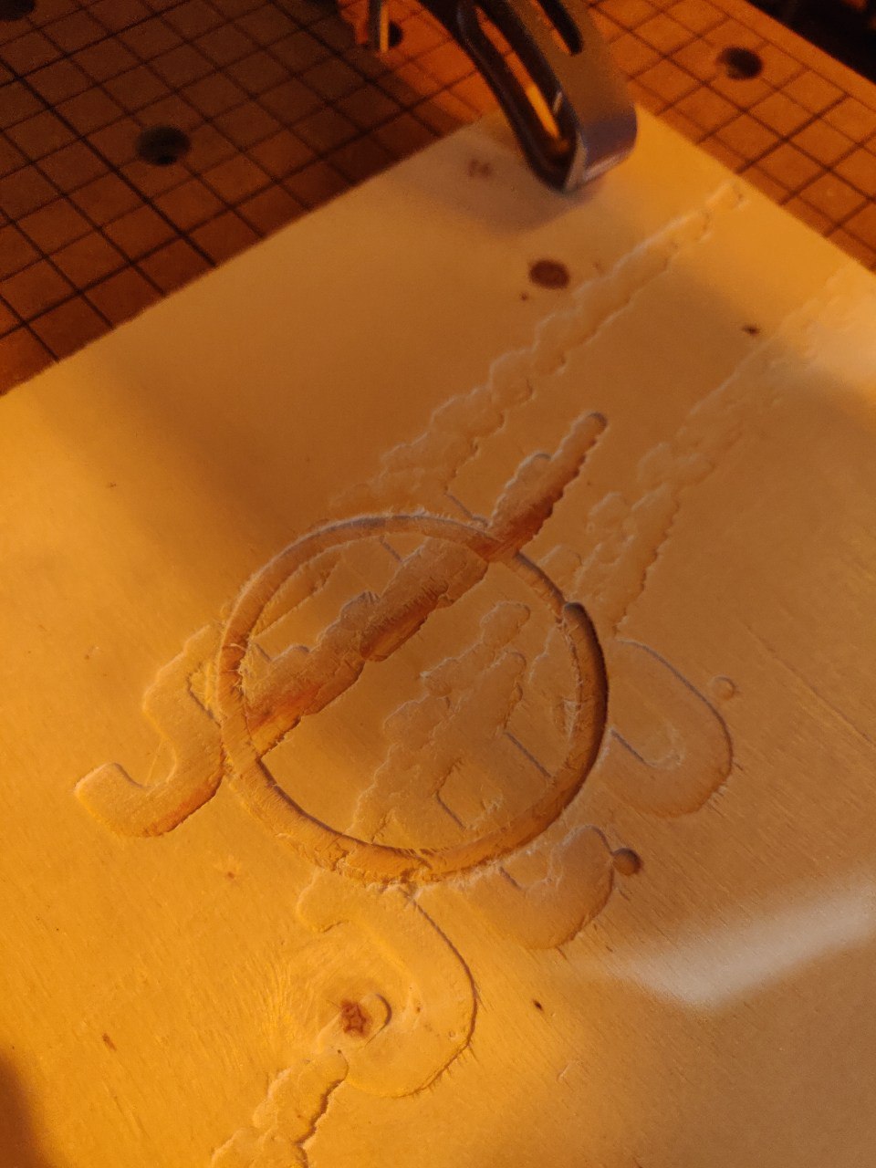

I am running some milling tests on the Snapmaker 2, and there is a huge shift in the x axis during the job.
It seems like the work origin is translated, because if I cancel it and go again to the work origin, it is far more right than I intended.
Could please somebody tell me what I could be doing wrong or has somebody else a similar problem?

This is where I’ve set the work origin before milling.
And this is where the work origin was after I canceled the job (went to home in between and then clicked on “Go to work origin”.
The problem occurs when I start from Luban and from the touchscreen. I am on the latest firmware V1.15.12, but the problem happens also with the three versions before.
Would be great to hear if the shift to the right is something I can fix, or if its a bug in the firmware or if it’s just the general state of the world right now.

  2. I have attached a screenshot from the toolpath settings, they have been the standard. But I have also set veeeeery slow speeds with 40 mm/min, and the problem occured as well. I tried this with a simple circle and I will attach another picture showing how the second turn is about 1mm more to the right.

I would also like to mention that the problem first occured after updating the firmware (from V1.14.1 to 1.15.12). Before that I had another problem which got solved by updating - but now this came up. So the issue of shifting to the right was not present two weeks ago. Reverting the firmware to 1.14.1 does not solve the issue.

That is exactly what is happening over here! Thank you for sharing. It starts shifting to the right after some time, once its getting warmer. I also get a “scratching” noise, when it is moving to the left of the x axis, as if there is a force pushing against the movement.

There seem to have been issues with 1.15.x before 1.15.15. Since 1.15.15 these issues seem to have gone. That said, there are indeed reports of failing modules, so it can be both. If I was in your shoes, I’d test the newer firmware first :slight_smile:

"We recently modified a known issue, which is the overall offset of home offset, involving the laser and CNC origin, which should be solved by the latest firmware pushed by the user through the upgrade.
At present, the latest version is V1.15.21. It has been pushed and can be downloaded and updated through the Internet. Users who have not purchased the dual extruder can use the V1.14.3 version. There is no such problem either."
So yesterday I put the recommended firmware on the Snapmaker and also updated Luban. Since then everything seems to work fine. I the following setup now:
Firmware: V1.14.3
Luban: 4.7.0
I have the impression that the issue has been gone with the Luban update actually… I remember I had the same firmware version installed once like the recommended one, but the issue happened there also.
