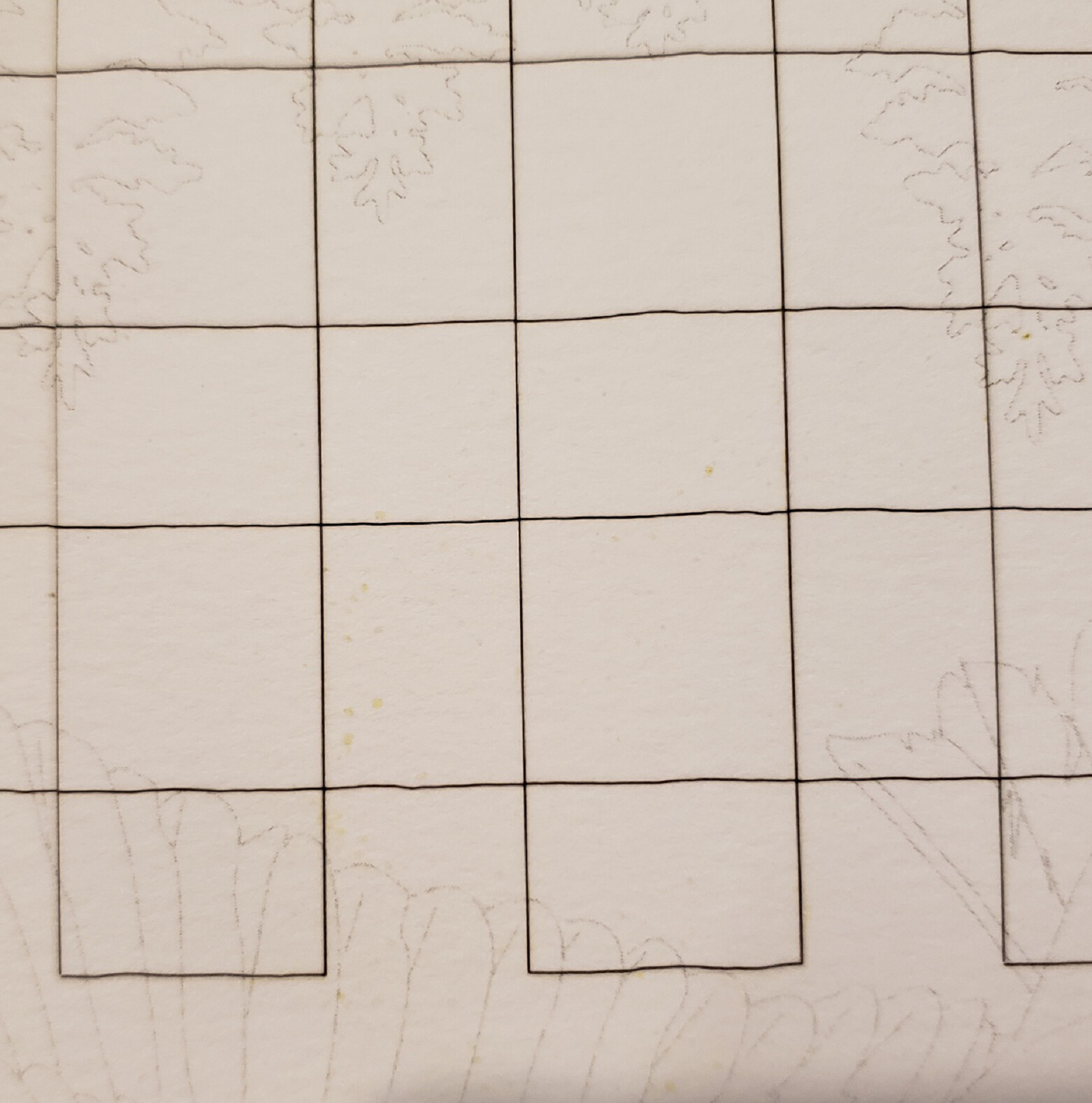

I have the A350 with enclosure. I was successfully doing a lot of laser cutting experiments, switched to the 3d print head to do a long project for a friend (lots of trial and error). Before I switched back to the laser, Luban updated and the firmware did as well. I am new at this and not sure how much is user error and how much is machine/sofware error.
When the toolhead moves along the x axis it makes a cracking/snapping sound, almost like the metal piece that covers the front has warped. On a project I just engraved, some of my lines look really wobbly too. Should I try to take my X axis apart? Or file a ticket?
Test Grid on cardstock paper.

That’s definitely not right. I would assume you’ve got a bad rail (or two).
Is there play in the x-axis?
If you try to tilt it back to front or left to right is it tight or does it rock?
I’d email SM support with all the info and your photos and get a warranty claim started.
Let them tell you to take it apart.
It maybe moves just a little if I try to tilt it back to front? This is such rotten timing… I’m in the middle of a project. -_- Thanks for the reply, I’ve submitted a help ticket via the Support page. Wish me luck~!

In order to make sure the material is not bent, you can use a wood board to try again.
As for the cracking sound, you can try to tighten the steel strip with the adjuster we offered.

Actually it was a piece of wood where I first noticed the wiggly lines! This leaf was oriented horizontally for the print in order to fit on the wood properly. You can actually see various line wobbling, particularly on the cut edges where I made two passes to cut through the 1.5mm plywood.
Thank you so much for the video, I’m going to try that a little later today.
The wobbling lines may be caused by the software. If you select Vector mode, the lines might be deformed slightly.

Edit: I also did a camera calibration, and you can see here that the x axis line is wobbly again. so I’m fairly certain it is a mechanical failure and not the g-code.
I’m positive it’s a mechanical failure, what with the snapping. Something inside the rail is snagging, releasing, snagging again, and releasing. I haven’t actually seen what the inside of the rail looks like other than pictures of the different pieces. I haven’t seen how it’s rigged up so I haven’t any idea. I know what’s in there but again don’t know how it’s oriented.
