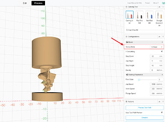

Why the model is not hollowed when I select "Linkage" in Snapmaker Luban
Some users reported that the module is not hollowed in Snapamker Luban even they select “Linkage”.

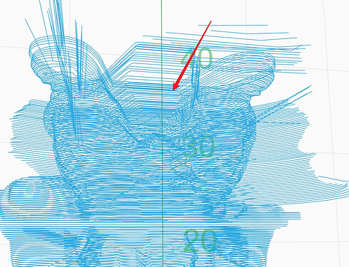

When you simulate the model in Snapmaker Luban, the previewing module will not show the hollowed area, because emulation can consume a lot of computer memory, which can cause software crash.
If you observe the toolpath of the model, you can see that the area between the legs is hollowed out.
The model is the same as that one in the promotional advertisement when you select “Linkage.”
Cheers
Edwin
