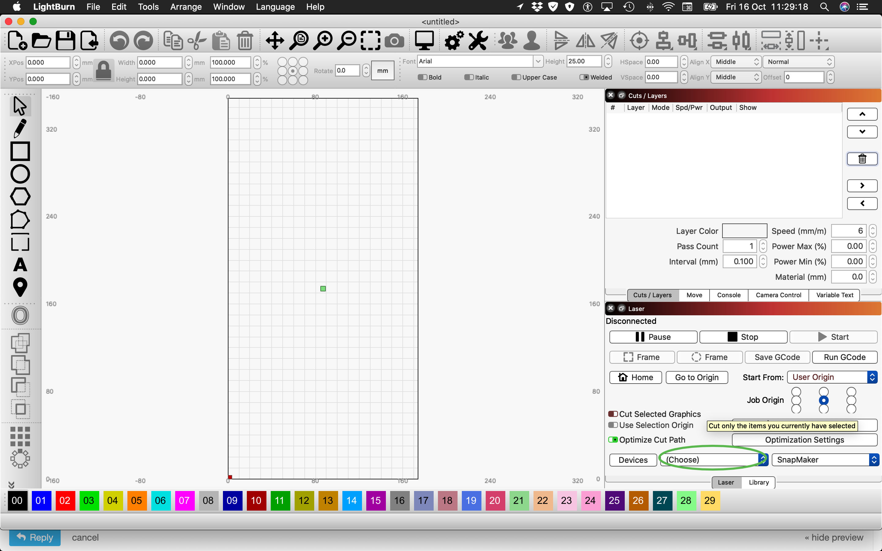

Hello Gary. I have not seen anywhere else to make the setting changes. I can tell you that initially there was an issue as to which way round things were initialised. My routine was to plug in the USB lead to Snapmaker and turn on the computer. Initialise Lightburn and the bottom right hand corner of the screen should tell you which Laser printer it is configured for.
In the first image below you can see that it is set up for Snapmaker (highlighted in red) which I set and had entered from the list of manual entries. I think I also selected GRBL 1.1. On a Mac the serial port that you should select is wchusbserial1410. In the second image that dropdown menu box is highlighted in green. It does not contain anything now because I have no connection to any machine right now as my SM1 is sold and I am awaiting the new machine.
So just connect everything in sequence and you should be good to go.
