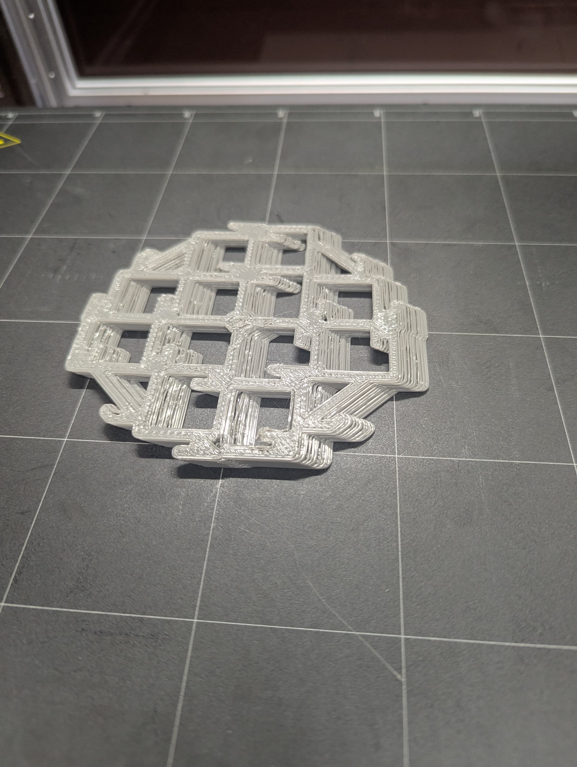

Can someone let me know how to correct the layer shift problem after installing the VC software update?
I would suggest to lower the acceleration (or print speed).
From:
M201 X3000 Y3000
To:
M201 X2500 Y2500 (or less, depending on your speeds)
Enter it in the terminal when your machine is connected and don’t forget to save with M500 .
Forgot to update my friend… actually it was a play around with accelerations and speed rate… I get them down to 1k and now all is working properly back. I am using orca Slicer so I just update them into the profile. By the way I would suggest everybody which is using Orca Slicer or Snapmaker Orca to uncheck the option of precise wall… that option makes X axis to draw unnecessary lines or leave bumps on X axis like if there where some jumps in the nozzle when printing…

@Jade I also ran into the issue that the califlower I printed, consistently shifted in y direction with the beta firmware and vibration compensation disabled (S0)
Hello, there might be an issue with the acceleration or Jerk settings. If you’re using Snapmaker Orca, you can adjust them in the speed tab. Try setting the acceleration to 1500 or lower and the Jerk to 5 for now.
As needed, adjust the maximum speed, maximum acceleration, and Jerk settings in the Printer settings as well.
So you mean it is a mechanical issue with skipping steps? Because than it should also occur when running the same speeds without the beta firmware am I right?
Some settings in Snapmaker Orca may be based on the assumption that vibration suppression firmware is enabled. Even if you later use another slicer, these settings can remain if their values are not overwritten. Therefore, if the maximum value has once been embedded, setting it to S0 might not resolve the issue.
My approach is to lower the value once, apply the setting, and write it to the machine to try to solve the problem.

@mhb This is likely caused by the speed/acceleration being set too high, which led to skipped steps.
FYI. You can check the default maximum acceleration and maximum print speed by sending the G-code command M503. These default values are what we recommend as the safe limits.
Different machine models and different conditions (e.g., whether Vibration Compensation is enabled, and whether you’re using 8-lead or 20-lead screws) will have different defaults.
You can restore factory settings to see the original default values as well. Re-enabling or disabling Vibration Compensation will also show the corresponding defaults. Of course, if you haven’t changed anything, the numbers you see are simply the defaults we set.
