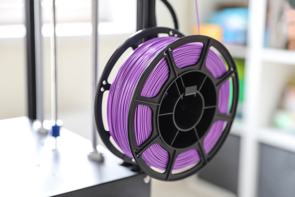

Drying filament - what MarkJ says: Just putting it into desiccant beads will be a painfully slow process - at least I assume so. If you do not have a filament dryer, then a simple oven will do the trick:

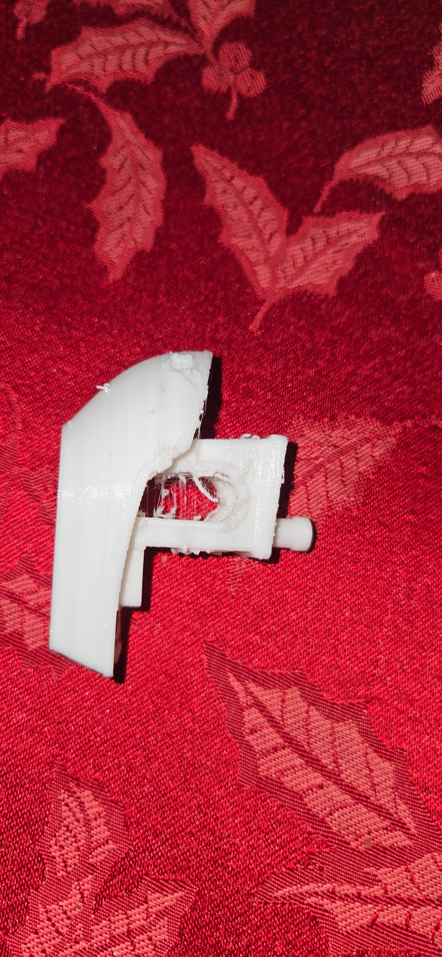

Sorry for the delayed response. It takes this long to get a filament dehydrator to get this deep into the rainforest. While not perfect, 12 hours of dehydration at 50C yielded these results:
And here’s the remaining imperfections. Mostly very small warts. Next I am trying 24 hours at 55C with my slightly better taken care of spool. Further advice is still happily accepted of course.
