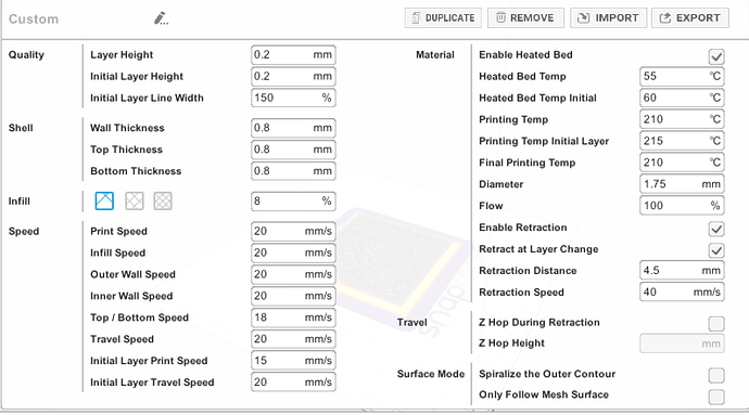

I have just incurred my first error. When doing a 3D print, it stopped mid print after an hour with this message:
2018%2003%2004%20Failure
Is there an explanation of the Thermal Runaway message?
I had been using the printer a good bit over 24 hours on different prints. I have turned the printer off, will let it cool and re-try later. Below are the settings that I was using.
BTW I am running the new beta firmware upgrade.
Have a great week.
Doug
