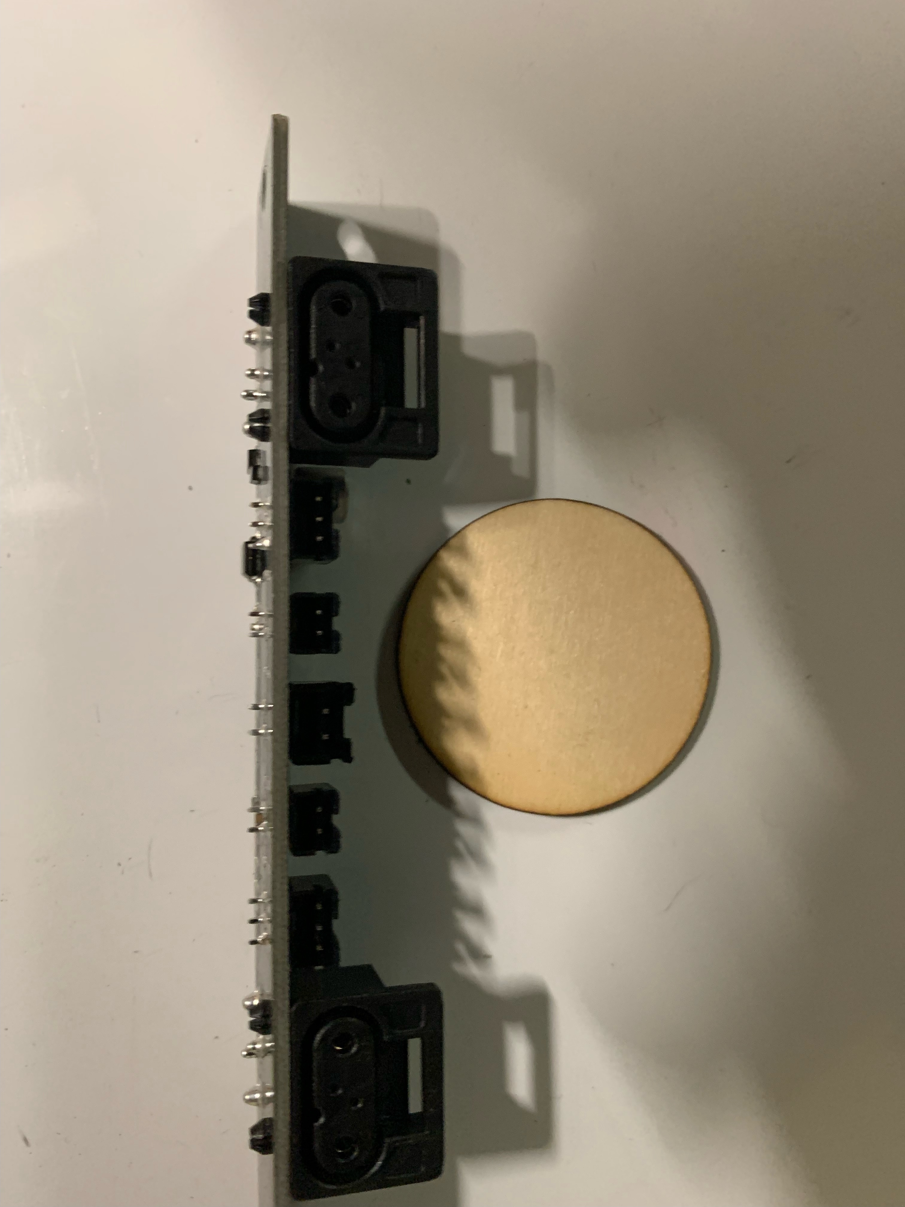

Hi , I’m very new to both 3D printing and the Snapmaker. My problem is with the Enclosure for my Snapmaker 350. The work ok when i first put it together and connected it to the machine, I could see it on the control screen and could turn the lights and exhaust fan off. But now it has gone from the screen completely, I have un plugged the cable from the enclosure and checked it, I have checked for new firmwere but is its not working. Any ideas of what the problem could be would be appreciated.

If it had recognized it in an intermittent pattern, I’d suspect the hub inside the enclosure where everything plugs in, but that may not be what’s going on with it. As @3DSW said, unplug everything and plug it back in, I also vaguely recall something about a firmware bug requiring a complete factory reset then updating to the latest firmware again.

@Madg ok so it’s intermittent. Unfortunately this means either the hub on the top back rail of the enclosure is bad, the cable is bad, or the port on the controller that the enclosure connects to is bad. You need to contact support at this point. Hopefully it’s just the cable but I doubt it.
Hi
Just an update on my issue with the enclosure, after a bit of fault finding with some help from snapmaker support it turns out I had a faulty PCB in the enclosure Hub. Snapmker have sent me a replacement and everything is working as it should
