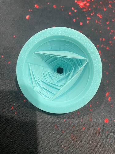

Anyway, my Snapmaker U1 is suddenly having issues with a part that I’ve printed many times before.
It seems I can only upload one image, so I’m uploading the image showing the error directly, even though a comparison with a flawless part
would certainly be helpful.
I hope someone can tell me where the problem lies, because I don’t know what to do now.
Thanks a lot!

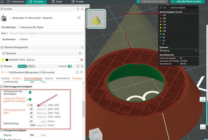

Your overhang speed is too high. You need to reduce it. Check this example with your model:

It’s also hard to see exactly. But it seems to me that it was printed with a relatively large layer height. For these angles, you should use a layer height smaller than 0.2 mm with a 0.4 mm nozzle. Maybe try 0.16 mm or 0.12 mm.

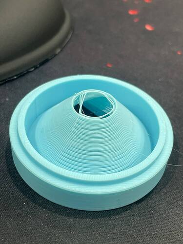

Here’s another image that shows the problem a bit more clearly.
You said it printed fine before so something has changed. Are you printing the same file off the printer or resliced it & sent it to the printer?
Appears to me that you may be under extruding a bit & possibly to much cooling. I’m thinking that the filament is cooling to fast and shrinking. Have you tuned the filament your using or using a generic profile.

What version of Snapmaker Orca are you using? When I updated to 2.3.3 and 2.3.4 prints came out similar to yours, Reverted back to 2.3.1 and prints perfectly again.
I emailed Snapmaker about it and they confirmed the update path optimisations has caused the issue and will address it future releases. Please contract them about your issue so hopefully they can speed up the fix if more people bring it to their attention.
I’m surprised you ever had success printing that. The inner cone shape’s walls look too thin to me, there needs to be more for the next line to bond to, even with inside-to-outside. Also, the nozzle temperature could do with being a bit higher (to increase the adhesion), and it would definitely help to make the layers thinner.
It’s all very well having an unsupported overhang up to 60º (this looks like 45º), but that only really works when the overhang is on a convex surface. When the line gets drawn, there is tension in the filament as it leaves the nozzle (not fully molten, otherwise it would just run everywhere). The tension tends to straighten out any curves or angles unless there is something to stop that happening – such as the inside tracks on a convex surface, or pure adhesion to the adjacent line or the layer below (or the bed).
As for adhesion, I wouldn’t really want to see that amount of definition in the outside of the cone, it looks like the lines are not well adhered and loose. Temperature and/or flow rate is a bit low.
Frankly, this print has not been designed and/or sliced for success.
That’s not similar – that’s either stringing or a slicer error (and what you say indicates a slicer error). The OP has the correct paths breaking away, and he implies he’s using the same print file so slicer updates are irrelevant.
If you read the original post, they say they printed that part many times fine before. Same with my print, it’s been printing no issues. But it’s suddenly printing bad, what’s changed? The slicer, as soon as I revert back to 2.3.1 it print perfectly. Something with 2.3.3+ is causing it to not retract or something and causing that really bad stringing.

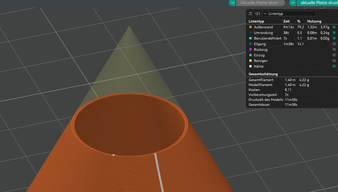

This construction is quite strange and not easy to print. It looks like there are only two print lines side by side. How thick is the cone? Please take a screenshot of the model.
We can only offer general advice here and provide meaningful tips once we know the slicing parameters used for the model. Otherwise, we can’t make any progress. Statements like “everything worked before…” don’t help us here.
As an example, this model is very unstable and not particularly easy to print. You have to experiment with the parameters.
