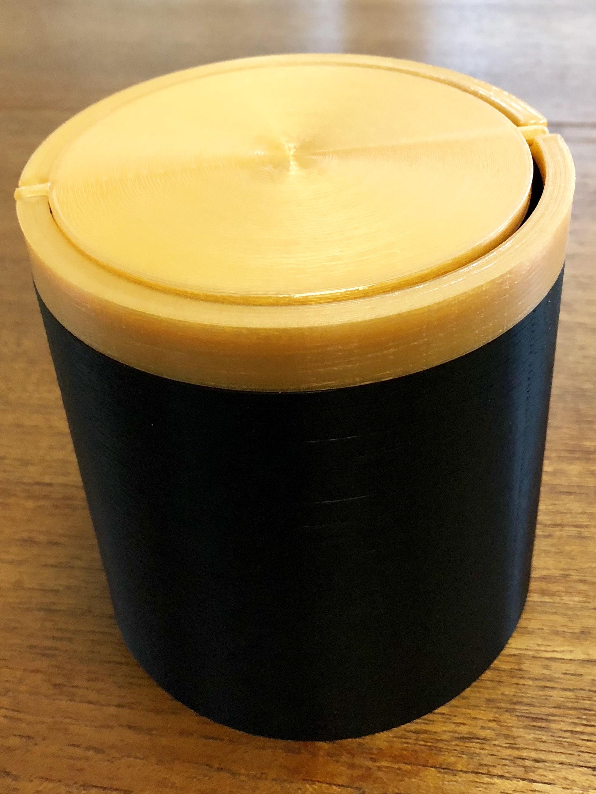

I printed this trash can designed by the @Leonardo of the Snapmaker team and available on Thingiverse.com at: https://www.thingiverse.com/thing:2742269
I’m very pleased with the result. I printed the main body at 0.3 mm and the lid and ring at 0.2 mm. Main body took 12 hours, the other bits about 2 hours and one hour respectively. Sliced with Simplify 3D. Materials are 3D Fillies PLA+ Black and translucent orange printed at 210 degrees and highest speed (for infills) at 100 mm/s.
I’m amazed at the quality of the main body when printed at a supposedly very rough 0.3 mm. The Snapmaker really is an extraordinary little machine. The bin is very useful for keeping my print area free of all of those little scrap bits of plastic which accumulate after a day’s printing.
