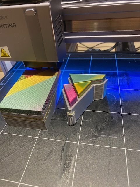

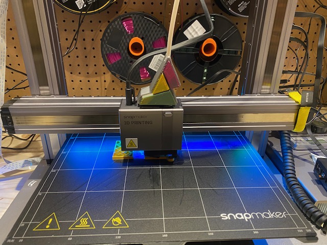

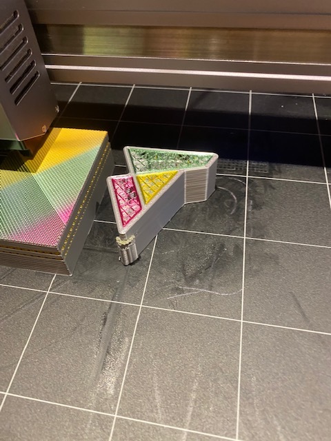

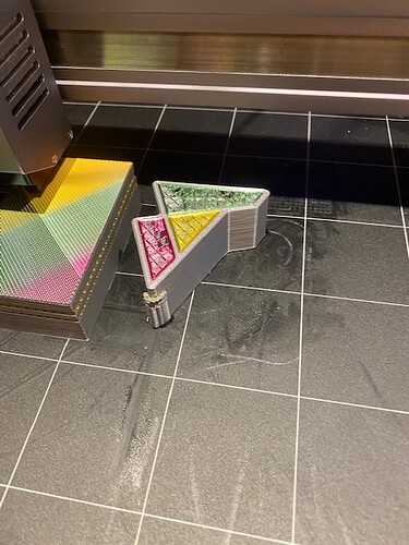

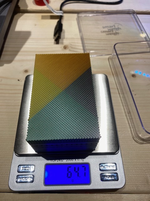

So it has taken me some time not only to get my “new space” set up but to get the Palette 2S set up and functional also. while not an easy task wasn’t the most difficult thing … the Raspberry Pi running Octoprint created some challenges as well! all new tech to me! still much to learn and much to tune in! while my first print, (albeit too large for a calibration print)was not a raving success, neither was it an epic fail. colour bleed along the way and at collar change intervals. I will use smaller prints in the future to calibrate the Palette. the purge block was nearly 3x the weight of the print but I think will make a nice collage once many are gathered! here are some pictures. if you have suggestions or need to gather my information (won’t take long :slight_smile: ) leave a message here. here are some of my pictures. sorry don’t have octolapse set up yet. the print was for a guide for the Bowden tube from the Pallette.IMG_6670

Move this down: to the middle of the Z travel range, and shorten the bowden tube as much as possible:
That will reduce how much needs to be wasted.
Also, I believe I saw an option in the palette software to purge in infill, which could also reduce the size of the purge block, geometry dependent. There’s also some other clever methods they came up with reducing purge wastage.
It would be really neat if the palette could just be mounted upside down on top of the toolhead - then the waste would be near zero. If not rigidly, like a flying bowden, suspended on some elastic bands.
Thanks @brent113 this is all of the filament that was left at the end of that print. (see attached) I believe that you are right about the setting regarding purge in infill … will dig into that deeper … working now to get the calibration accurate to stop the colour (or color depending on geography) bleeding.
I should start a new thread so that others can more quickly reference info if needed … but for now … so I found the location for using infill for transition.
a few other useful settings here too

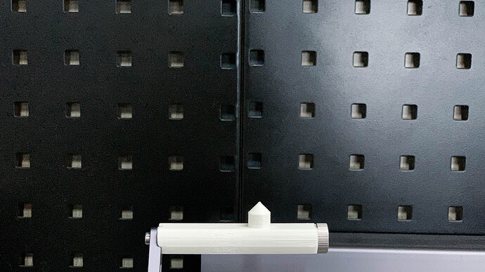

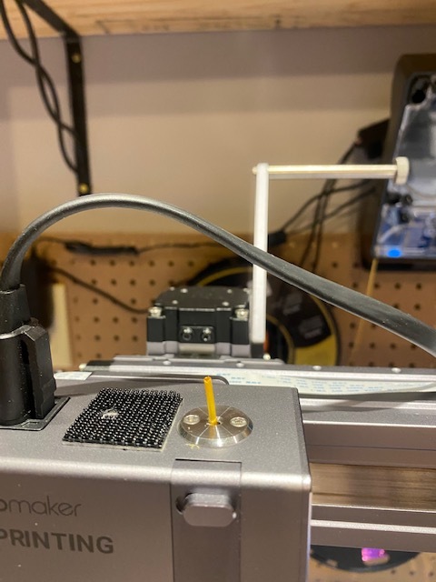

Hello all, Just got my A350 and my pallet2 pro, do you guys have a place i can find a bowden adapter for the toolhead of the A350?
Something like this?
PTFE-Anschluss-A350.stl (643.4 KB)
Have fun! :wink:

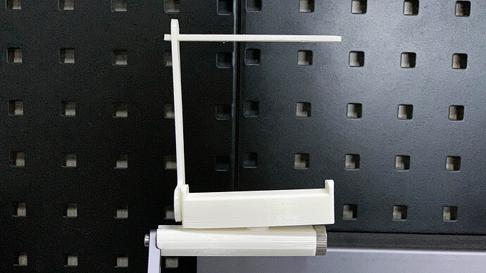

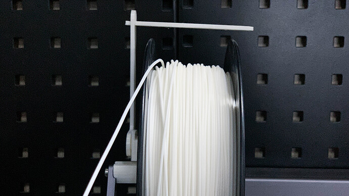

I just create that adapter.
How about this.
Filament Guide
:point_right: Rotatable base eliminating irregular sway of the spool
:point_right: The piece on the front holding the filament in place
Download here: http://bit.ly/3rnFoDL
